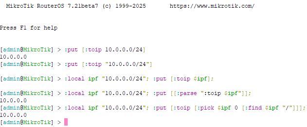

Until recently, to get the IP address from that string, you have to strip the netmask (with :pick and :find), then call :toip on the result.
Starting with 7.21beta7, :toip can be used to convert a value of type ip-prefix to ip, which means this now work:
:put [:toip 10.0.0.0/24]
However, it doesn't work if converting from string. So, both of these don't work:
:put [:toip "10.0.0.0/24"]
:local ipf "10.0.0.0/24"; :put [:toip $ipf]
In case your input is a available as a string in a variable (in this example $ipf), you'll need to do this in 7.21beta7:
:put [[:parse ":toip $ipf"]]
With older versions, like 7.20.4, this is still required:
:put [:toip [:pick $ipf 0 [:find $ipf "/"]]]
