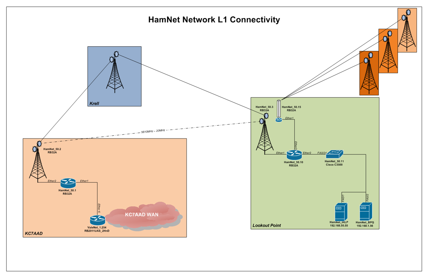

I for one, and planning my HamNet with my own doings. I will use my ISP for some external links outbound from the rest of the network, but not general port 80 type (web traffic for a lack of better term). Mostly BBS, Ham related FTP, some enhanced service hopefully like mumble chat, sms… Things that you couldn’t do over normal “Packet” because it was too slow. I do plan on offering connections to Telnet Nodes and RF Packet Nodes through this as well. Kinda a one stop shop concept.
HamWan.org out of the Seattle area is doing this, but they are integrating it into 44/8 too, and offering more of WISP services I believe. I haven’t really gotten a handle on what they are offering / providing. There may be a few more of these types of systems out there too, just haven’t heard of them yet.
