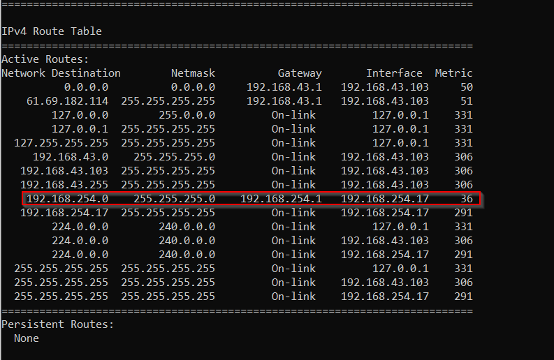

I have a RB4011 and have setup L2TP based VPN access for all my workers out in the field. This works well except for one issue.
When I set Windows to NOT 'use default gateway on remote network" (aka Split Tunnel) I cannot see my whole network.
When this option is selected, the following route is added to the route table.
The problem is that the netmask portion is wrong for my network and effectively cuts off routing to half of my subnet.
Questions: Where is this route generated from? Does Windows make this up? Is this information passed from the VPN itself? Does Mikrotik have a config I need to be looking at?
I simply dont know where/how this route is generated in order to find a way to correct it.
My old VPN solution did not have this problem. Same network. Same subnet. Same Configuration. But using PPTP on different hardware.
Thanks.
So, with no responses. I was able to figure out a solution myself.
The answer is, that Windows is the device the comes up with the route and inserts it into the routing table. This involves a little know setting called “class based route addition” which can be turned on/off. Windows assumes you will be working within your network class and address the route accordingly.
The solution is to use powershell.
Add-VpnConnectionRoute -name "VPN Name" -DestinationPrefix 192.168.X.X/23
this is an example, but you can figure it out. once this has been added, it effectively creates a route just for the VPN. This fixes the issue and routing starts working.
