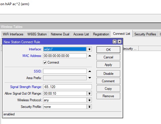

.https://wiki.mikrotik.com/wiki/Manual:Interface/Wireless#Connect_List
You can limit the signal level at which the station can connect to the access point, but you need to ensure that the wifi signal covers the entire necessary area. For example set the minimum signal level -65, the station receives the signal from AP1 with the level -66 and respectively disconnected. After disconnection the station is looking for another access point, scans the air and gets the level of AP2 -67 level of AP3 -71, respectively, the station will not be able to connect anywhere.

As you described the problem is solved exactly with the Connect list.
The principle of the Wifi station holds on to the access point until the signal drops to -68. At this signal the station begins to look for an access point with better parameters if there is one it switches, if not it continues to hold on to the old access point. The best parameters include not only the signal level, there are several criteria. And as a result the user thinks that the station must switch over, because the signal from the other AP is stronger, while the station thinks it gets better speed at the old one. In this case the connection list rules will make the station disconnect from the first access point. And then the radio engineer’s task is to design the network, to arrange the access points so that at the moment of disconnection in this place there was a signal from another access point with better parameters.
