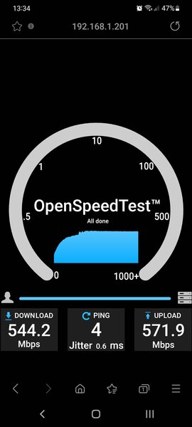

Whats funny i got better speeds with 7.2rc4. and old wave driver than new wave2 drivers on HAP AC3, this is ideal conditions 2m from AP, S21 Ultra, pretty amazing if you ask me.
