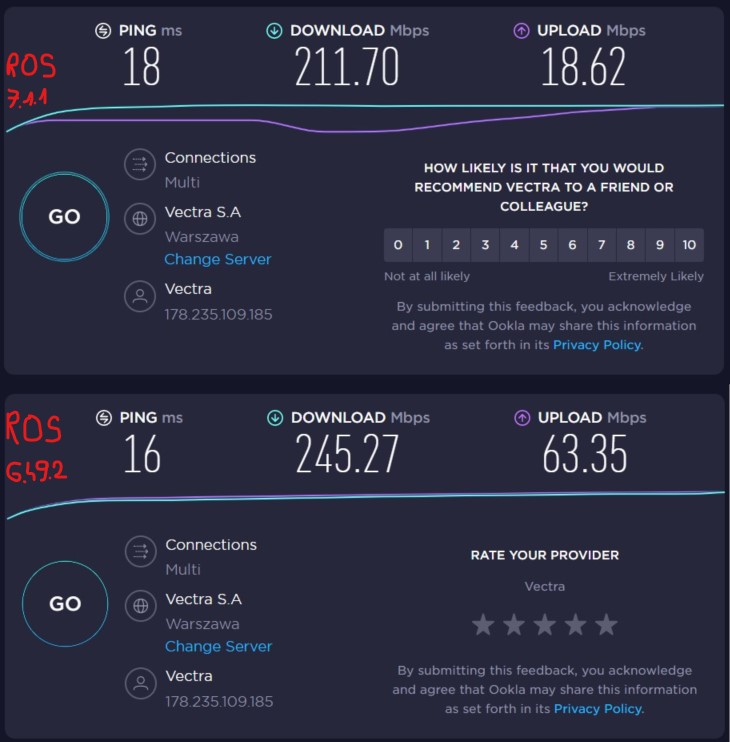

I have a problem with ROS version 7.1.1. on wAP ac old devices (RBwAPG-5HacT2HnD on mipsbe). The problem mainly concerns 5G WiFi and is manifested by a decrease in speed towards the upload. The problem does not occur on wAP ac new (RBwAPG-5HacD2HnD on arm). I did not observe the problem on hAP ac3 (RBD53iG-5HacHnD on arm). After downgrading to 6.49.2 the problem disappears and even wAP ac new (RBwAPG-5HacD2HnD on arm) and hAP ac3 (RBD53iG-5HacHnD on arm) work better (more efficiently). The screenshot shows an example of 5G WiFi transfer for a 600/60 Mbps Internet connection. The same problem is in the internal network, e.g. when copying files via WiFi to a NAS in the LAN network (even the WiFi connection is broken / disconnected).

I indicated the specific MT models with which there is a problem with the new software.
Not only do I have these symptoms after updating these MT models.
