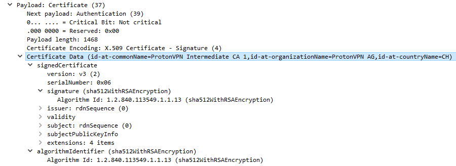

  2. I extracted Intermediate CA certificate from IPsec ISAKMP phase (IPsec debug output from RouterOS + Wireshark :smiley: )
    Here is certificate in DER and PEM encoding:
    ProtonVPN_IKE_Intermediate_CA_1.tar (6 KB)

    Сlient DOES NOT HAVE to have the entire chain of certificates on its side in order to build correct certificate chain.
    Client only needs to have a root certificate to verify entire chain, provided that the server provides all intermediate certificates.
Successfully tested on 7.9.1 with 2 installed certificates(IKE_Root_CA + IKE_Intermediate_CA_1) on ProtonVPN.
At least as temporal solution :slight_smile:
