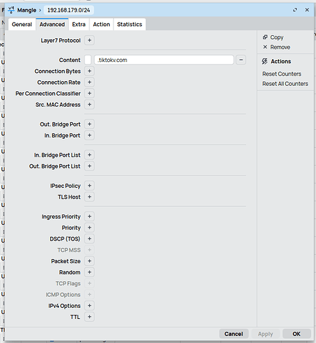

I want to block TIKTOK with mangle rules on my Network but can´t get it working.
I tried the following what worked on 6.49.18 (please look at the mangle rules):
2025-11-05 15:35:31 by RouterOS 7.19.6
software id = J0BH-F8BL
model = L009UiGS-2HaxD
serial number = yes_it_has_one
/ip firewall mangle
add action=add-dst-to-address-list address-list=TikTok address-list-timeout=
4w2d chain=prerouting comment="*** TIKTOK" content=.tiktok.com
src-address=192.168.179.0/24
4w2d chain=prerouting content=.tiktokv.com src-address=192.168.179.0/24
4w2d chain=prerouting content=.tiktokcdn.com src-address=192.168.179.0/24
4w2d chain=prerouting content=.byteoversea.com src-address=
192.168.179.0/24
4w2d chain=prerouting content=.ibyteimg.com src-address=192.168.179.0/24
4w2d chain=prerouting content=.ibytedtos.com src-address=192.168.179.0/24
4w2d chain=prerouting content=.myqcloud.com src-address=192.168.179.0/24
add action=drop chain=forward comment="Block TIKTOK" connection-state=""
dst-address-list=TikTok src-address=192.168.179.0/24
The "TIKTOK"-List is created, but no TikToK-Addresses are added to the list.

Sure this is correct? Can you remove it and test again?
Aah...then it won't work at all...obvious.
That should bring you to the question...why is the address-list not filled?
According to the documentation there is no "content" property in mangle:
I have it corrected and tested, still no addresses are added to the list. That's exactly what I need help for.

where content is there allright (as stateless string matcher property)
Point is that if the connection is http then packet contents can be looked for, if it is https, they cannot.
Even the "RAW"-Solution Normis is showing here https://www.youtube.com/watch?v=T2CQyN-D4u4 does not work for me. No traffic is shown in the Raw Rule. Does it have to do with that I am on the default-configuration?
No, it cannot be done (based on contents of packets), and tls-host is now (usually) also encrypted (tls 1.3 if I recall correctly).
Maybe I couldn´t describe my problem the right way due to my not perfect english. I created an address lists manually and now it seems to work.
Sure it works with a pre-made address list.
What cannot be done Is creating an address list with mangle base on contents of the packet, and as well tls-host won't be a valid matcher in most cases.

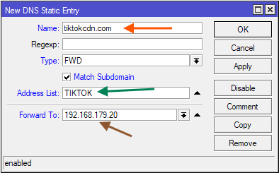

If you are able to force all client devices to use the router as DNS server then it might be achievable.
Once you've made sure that all clients have to use the router as DNS resolver. The next step is to add static DNS record of type FWD for each of the domains you want to block, for example (192.168.179.20 is the address of PiHole):
/ip dns static
add address-list=TIKTOK forward-to=192.168.179.20 \
    match-subdomain=yes type=FWD name=tiktokcdn.com
Eventually, also set IP -> DNS -> Address List Extra Time to some positive value, for example 1 minute:
set address-list-extra-time=1m
Once you've done adding the static DNS FWD records, each time the clients in the network queries for the domains, the TIKTOK address list will populated with the correct corresponding IP addresses. Because the clients have to resolve the domain before making the connections, you only need a drop rule in the FW for dst-address-list=TIKTOK.
This is much more efficient than looking into each packet for the Layer 7 content. The check only needs to be performed on the DNS requests.
But the above is usually only needed if you don't have PiHole. If you already have PiHole then just redirect all DNS queries to it (plus block DoH/DoT/DoQ) and configure PiHole to black list those domains.
