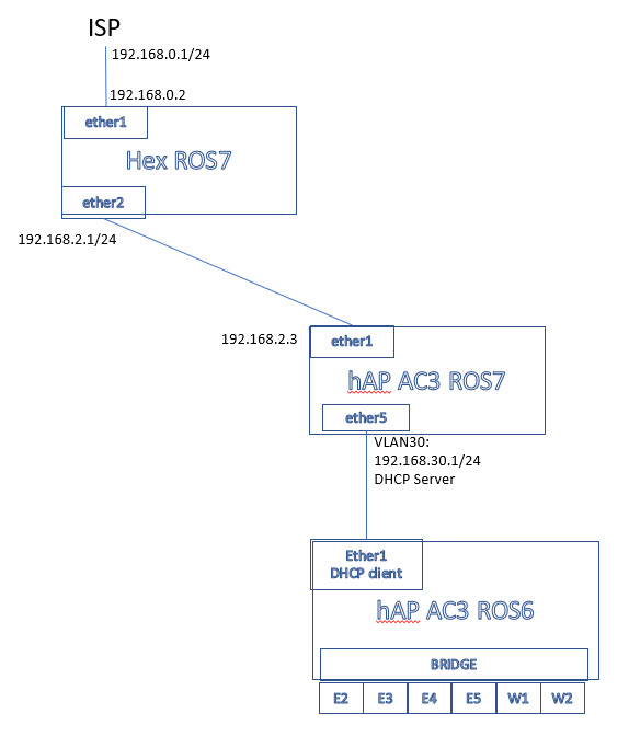

Drawing:
ISP modem
Connected to Hex
Hex to hAP AC3-1 (with hub in between, not shown for simplicity)
hAP AC3-1 ether5 configured as VLAN30, POE out. DHCP server configured on VLAN30
hAP AC3-2 blank config, DHCP client on ether1 so I would like to see it get an IP address from VLAN30-pool
I first would like to understand how it works for 1 switch port.
Bridge VLAN I have setup already, that works.
Next step I would like to understand is how to use wifiwave2 port with VLANs on hAP AC3-1. But my guess is this would not be possible using switch (since only HW ether ports are available there to select from).
So bridge VLAN only ?
And then gradually grow (I already have the final config in my head, it will start from Hex).
But I first want to understand the basic building block using switch … (and yes, I know the switch on Hex is different from AC3)
I think you should have a vlan tagged (trunk) port on the hAP AC3-2. Or make the ether5 on the hAP AC3-1 an accessport.
Thát last part I was already aware of :laughing:
And I was able to do so using the Bridge VLAN approach. But how does it need to be done using the switch approach ?
That's basically where I am lost in the woods ...
As far as I understood, if on AC3-1 it's defined as an access port, nothing else needs to be done on whatever you connect to it downstream. AC3-2 or whatever other ethernet equipment.
And otherwise I don't understand what the use would be of an access port.
Trunkt port, that's something else. But access port ?
