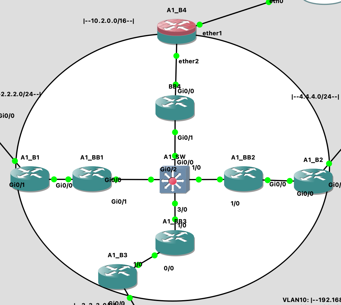

I'm currently getting started with Mikrotik but I'm have some troubles with RIP that I am unfortunately not able to resolve via some tutorials, as most still use the "old" ROS version.
My Situation:
As seen in the attchments my topology is mostly Cisco-based, with the exception for B4 which is a Mikrotik CHR. The Mikrotik Router should propagete the IPs of his tunnel-interfaces and its' lo1 interface.
