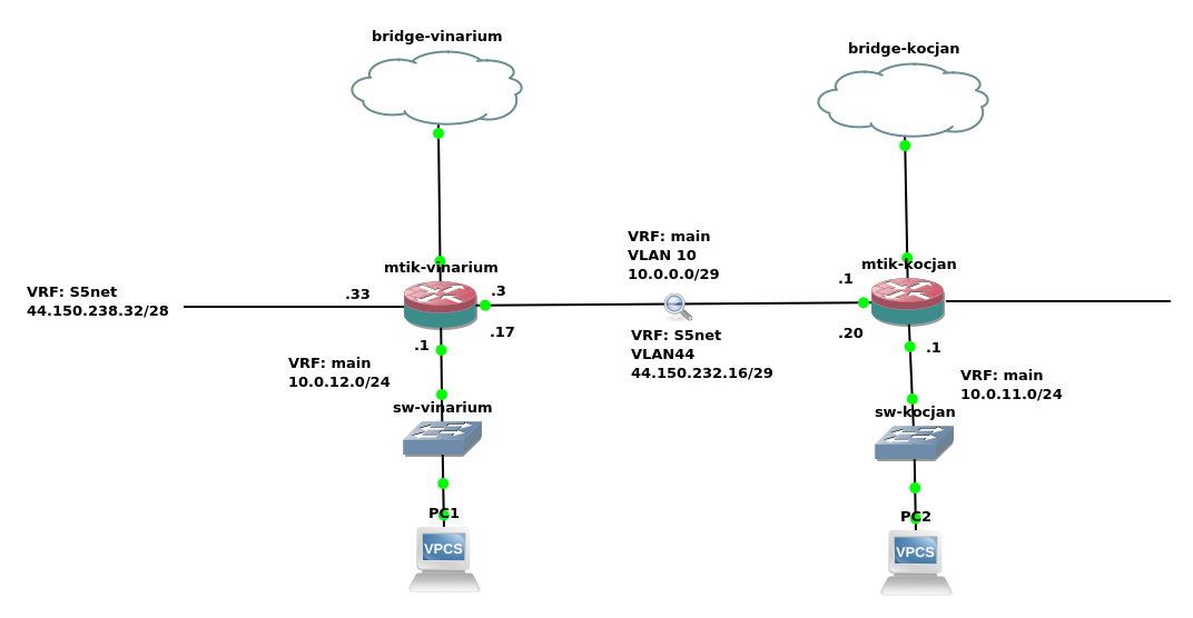

Before we go any further, I would like to describe my problem… I have 2 VRFs on each of two routers, we will focus on one of the routers (virt-vinarium), because on both routers I have same problem. First VRF if main second VRF is vrf-s5net. I would like to enable access to services like Winbox, SSH, API to devices from both VRFs, problem is that we can only assign service to one of them. Each of routers have two OSPF instances one for each VRFs. Both routers exchange routing info via link (which has VLANs) between them.

Results for testing ssh from virt-kocjan to virt-vinarum on 44.150.248.33:

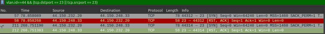

  • Router correctly puts packets into input chain
  • Router correctly forms and forwards response packet
  • Router responds with TCP RST if from packet incorrected VRF :frowning:
