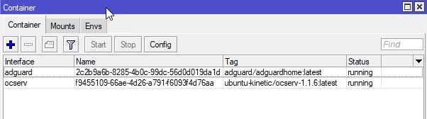

Right now, I’m working on a docker image for my OVPN. I even found a Plugin for Radius to MT.
It’s perfect example why I have mixed feelings about containers in RouterOS. On one hand it’s great that you can run anything you want, even exotic things that MikroTik would never add. But if I needed complete OpenVPN, I’d very much prefer if MikroTik finished theirs, instead of having to rely on containers, which means extra work, won’t have the nice and friendly RouterOS GUI for all settings, and will run only on subset of devices that support containers. And if I’d be paranoid, it can be also used as excuse by MikroTik, why they don’t have to finish their implementation.
I agree. However, in the past few versions’ log changes, There were a few changes to OVPN. It seems they are working on it. In the meantime, a container option is handy. Although, I raised a support ticket for OVPN problems.
I have two operational containers at my CHR. Overall, It’s a neat option to have. I think paying less for resources and gaining more from what you already have is always lovely.
