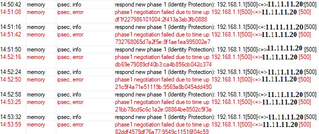

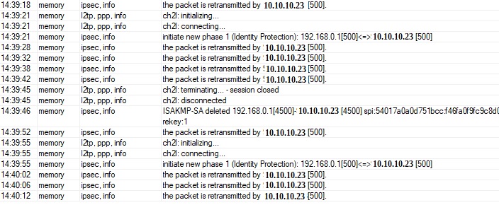

I have followed the instructions from https://wiki.mikrotik.com/wiki/Manual:Interface/L2TP#Application_Examples (Site-to-Site L2TP) on a different pair of routers and am getting error messages and no established connection. Can someone please suggest a possible solution?
(On the server side) 11.11.11.20 is the WAN address of the client
(On the client side) 10.10.10.23 is the WAN address of the server
