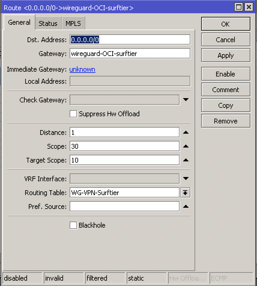

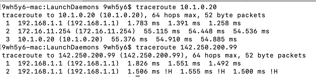

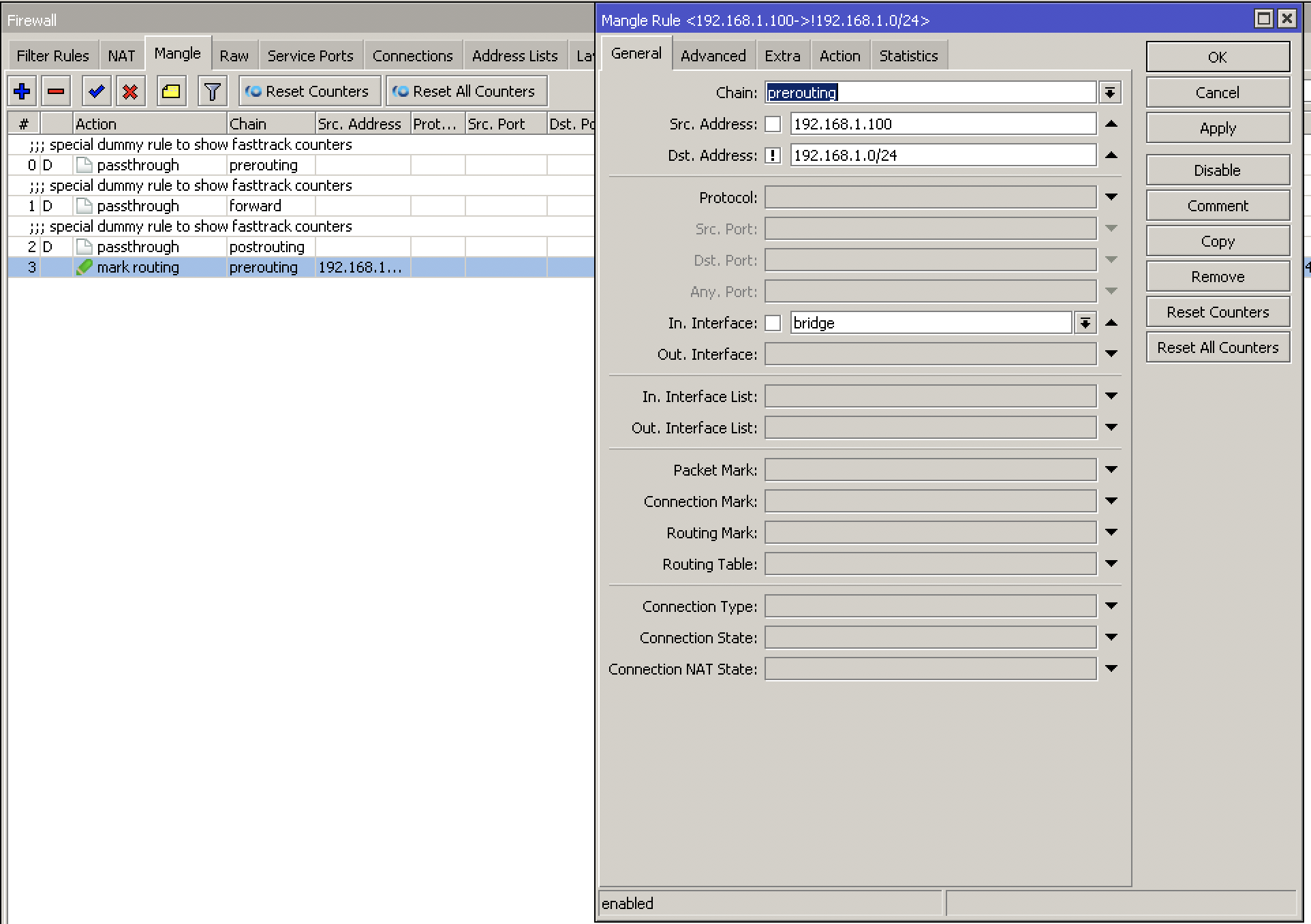

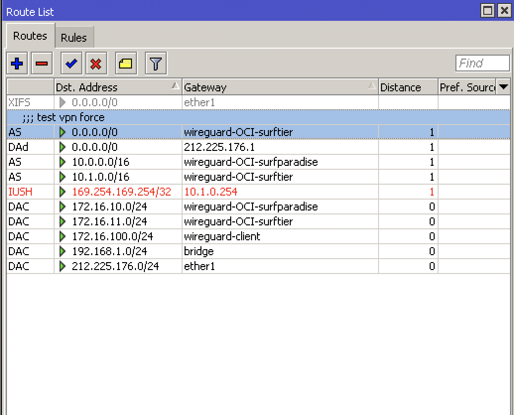

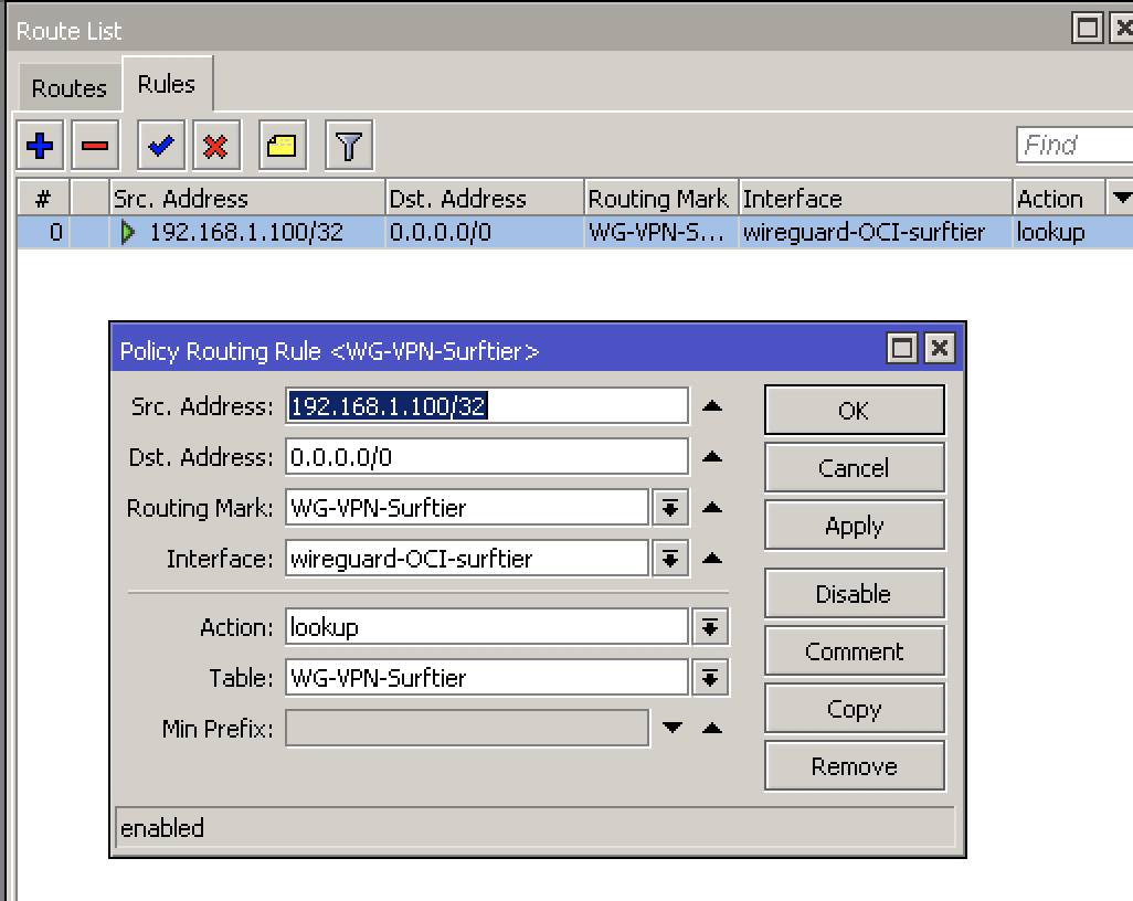

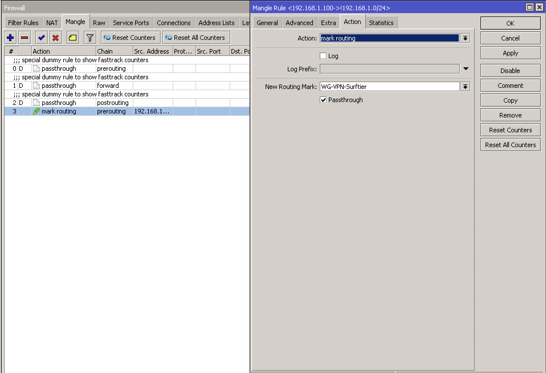

I configured a mangle to mark my traffic from 192.168.1.100 and a route policy that take this traffic on a secondary route table and route it through the interface of the tunnel. I can ping my remote devices, but the 0.0.0.0/0 traffic is not routed into the tunnel (the traceroute command output is attached)

Does your WG tunnel allow this traffic? Check allowed-address in peer’s config.
Yes, I don’t have any problems to ping my remote devices on the vpn site.

That’s not the question, I meant config on RB:
/interface/wireguard/peers/export
The peer should have allowed-address=0.0.0.0/0.
Ahhhhhh… got it!
The peer interface on the Mikrotik!
…Now everything works as expected! Thank you very much man!!
