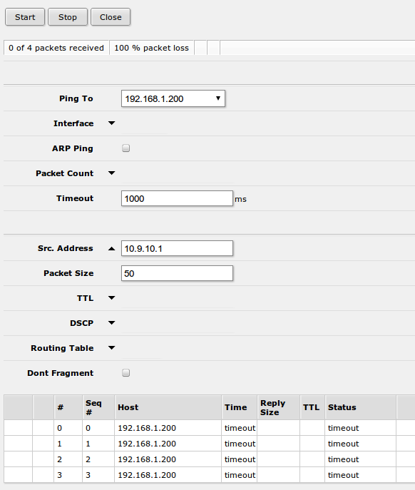

Route to 192.168.x.x Network - Not Routing?
Greetings,
I’m new to the Mikrotik world and trying to get my arms around the RouterOS from both the GUI and CLI side. But I have a specific problem/question. I cannot figure out why traffic is not being routed to a specific IP block/interface. The network is there, the route is there. I can confirm that the IP on the target network is pingable from the otherside back to the IP on the Mikrotik. From the Mikrotik using the ping tool, I can ping 192.168.1.185 using a src IP of 10.9.10.1. Setting the interface (eth3) to DHCP, it pulls DHCP. However, I cannot ping any other IP on the 192.168.1.0/24 network. Eth3 plugs into a switchport access port vlan 192. Plugging laptop directly into switchport, I can ping any IP on the 192.168.1.0/24 network. So I can stumped as to why I the traffic destined for the 192.168.1.0/24 network is not routing. Any help you folks can lend, would be mucho appreciated.
tonyd
Very basic network config:
No vlans, tunnels, etc.
Interfaces:
 	 	Name	Type	L2 MTU	Tx	Rx	Tx Packet (p/s)	Rx Packet (p/s)	Tx Drops	Rx Drops	Tx Errors	Rx Errors
D	R	ether1	Ethernet	1526	47.9 kbps	34.5 kbps	28	38	0	0	0	0
D	R	ether2	Ethernet	1522	33.0 kbps	28.3 kbps	34	28	0	0	0	0
D	R	ether3	Ethernet	1522	0 bps	0 bps	0	0	0	0	0	0
IP → Addresses
 	 	Address	Network	Interface
;;; Private NOC Internal
-D		10.9.10.1/23	10.9.10.0	ether2
-D		10.22.10.0/24	10.22.10.0	ether2
-	D	192.168.1.185/24	192.168.1.0	ether3
;;; default configuration
-E	X	192.168.88.1/24	192.168.88.0	ether1
;;; mtr.noc to cr1.esedo
-D		216.22.22.198/30	216.22.22.196	ether1
;;; Internal NOC Network Publics
-D		216.22.23.1/29	216.22.23.0	ether2
IP → Routes
	 	Dst. Address	Gateway	Distance	Routing Mark	Pref. Source
-D	AS	0.0.0.0/0	216.22.22.197 reachable ether1	1
-	DAC	10.9.10.0/23	ether2 reachable			10.9.10.1
-	DAC	10.22.10.0/24	ether2 reachable			10.22.10.0
-	DAC	192.168.1.0/24	ether3 reachable			192.168.1.185
-	DAC	216.22.22.196/30	ether1 reachable			216.22.22.198
-	DAC	216.22.23.200/29	ether2 reachable			216.22.23.0
Remember not just to ask “does my source IP have a route to the target” but also “does the target IP have a route back to my source”.
e.g. if you can ping the router’s own IP on that subnet but nothing else on the subnet then look carefuylly at the reverse routing - not to mention ICMP filters etc. etc. …
Thanks CelticComms…
I believe the answer is that it does. From the Mikrotik’s perspective; shown in the “Routes” list; both ways. Eth3 is simply connected to an access port on a vlan that is part of the 192.168.1.0/24 network. Question, is the reason I can ping ip addresses on the 192.168.1.0 network from the Mikrotik when “Not Using A Src IP” because it’s using the assigned IP to that interface, i.e. eth3/192.168.1.185? However, when I use a “src” address, that being the gateway address on eth2/10.9.10.0/23 network, it fails because it doesn’t have a route back? From my workstation on the 192.168.1.0/24 network I can ping 10.1.10.1.
Thank you again =)

From the Mikrotik →
Using a src IP on eth2 (10.9.10.0/23 Network on eth2)

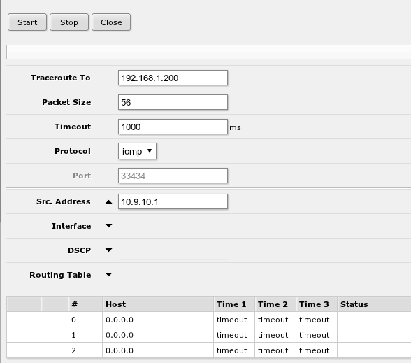

Do you have any forwarding rules in /ip firewall?
Why is this traceroute using 192.168.1.55 as the gateway? I thought it was supposed to go through 192.168.1.1.
root@tonyd-WorkStation:/home/tonyd# traceroute 10.9.10.1
traceroute to 10.9.10.1 (10.9.10.1), 30 hops max, 60 byte packets
1 pfsense.cor.company.net (> 192.168.1.55> ) 0.221 ms 0.220 ms 0.218 ms
2 10.9.10.1 (10.9.10.1) 1.780 ms 1.838 ms 1.911 ms
edit: My bad. The router ip on that localnet is 192.168.1.185. Isn’t that supposed to be the gateway?
@CelticComms - No IP/Firewall rules. I am NAT’ing the 10.9.10.0/23 network. The default GW for 0.0.0.0/0 is 216.22.22.197
@SurferTim - You’re correct, it is the GW for the 10.9.10.0/23 network. I use Zentyal as my internal Gateway/Firewall. It’s gateway to the world is 192.168.1.55. With respect to the 10.9.10.0/23 network, it’s reachable at 192.168.1.185. It’s a little strange I know. Basically, I acquired another local competitor ISP. They use Mikrotik; my network is Cisco exclusive. I have a direct microwave link into their core. So I defined a vlan to extend my internal to that core. I placed eth3 on that vlan, i.e. 192.168.1.0/24 network. My plan is to reconfigure that office’s network but due to deadlines to migrate their entire topology away from IP blocks that did not come with purchase (ARIN Non-portal) I tried to make it as simple as possible. I simply wanted to route at their end at the Mikrotik between the two networks.
Thanks guys =)
tonyd
Perhaps a diagram would help… This smells like a routing problem.
I’ll put something together… =)
Meantime you may want to have a look at the ether2 interface using Torch while you ping. It may show replies arriving which are not being processed which would be a good clue.
Please find the attached PDF Visio drawing. It’s stripped down to just the key elements relative. I can ping the Mikrotik’s Interoffice GW IP from the 192.168.1.0/24 network as mentioned. So I have a route back to the remote 10.9.10.0/23 network. The problem is I can’t ping from the 10.9.10.0/23 network to the 192.168.1.0/24 network. Again, no firewall rules, filters, acls, etc. on the Mikrotic. I have attached a config.
Thanks =)

I believe the problem to be at the Mikrotik shown by this traceroute from the Mikritok eth2 10.9.10.1 network to the 192.168.1.200 (why host IP 0.0.0.0 when there is a route in the IP/Routes showing a route the the 192.168.1.0 network on interface eth3?):
Thank you =)

I suggest not using the ping facility with set src address to debug this. Get a session on one of the workstations on the 10.9.10.0 network and run trace route from there. Why? Because traffic starting on the router itself doesn’t follow exactly the same rule application sequence as traffic entering on an ether interface - could be adding confusion to a confusing situation.

add action=src-nat chain=srcnat disabled=no dst-address=192.168.1.0/24 to-addresses=192.168.1.185
If I remember your overall system correctly I reckon this confirms that there is a routing issue - probably on the return path from 192.168.1.0/24 to the 10 network.
By NATing the traffic exiting 192.168.1.185 the return path is to 192.168.1.185 rather than directly to the 10 network.
btw - for that type of source NAT entry you can use action “Masquerade” and it will automatically use the (only) IP on that interface.
I here you, but don’t see where the there is an issue with the return path. I can traceroute to the 10.9.10.1 network and the path is via the 192.168.1.185 interface. So the route from the 10.9.10.0 to the 192.168.1.0 and back would follow the same path.
It hits my 192.168.1.0 gateway. The gateway has a route to the 10.9.10.0 network that points to 192.168.1.185 and viola, reaches it’s target.
1 pfsense.cor.company.net (192.168.1.55) 0.210 ms 0.206 ms 0.214 ms
2 10.9.10.1 (10.9.10.1) 9.977 ms 9.978 ms 9.974 ms
As I mentioned in my opening post, I’m new to Mikrotik, but have years of experience with Cisco, and with it, I have no problems. The situation, however, is that the Mikrotik must be used.
While I have this working, hack… I would like to understand why it’s not working how it should using simple static routes.
