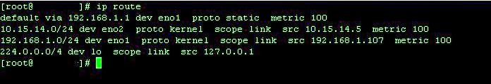

Server 1 Centos7 have two NIC’S one is connected to DHCP server and works ok for public.
But second NIC is eno2 has ip 10.15.14.5 and is connected to ether9

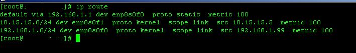

Server 2 Centos7 have two NIC’S and first one is connected to DHCP server for public traffic.
Second NIC is enp8s0f1 has ip 10.15.15.5 and is connected to ether10

Server1 route table
[root@~]# netstat -rn
Kernel IP routing table
Destination Gateway Genmask Flags MSS Window irtt Iface
0.0.0.0 192.168.1.1 0.0.0.0 UG 0 0 0 eno1
10.15.14.0 0.0.0.0 255.255.255.0 U 0 0 0 eno2
192.168.1.0 0.0.0.0 255.255.255.0 U 0 0 0 eno1
224.0.0.0 0.0.0.0 240.0.0.0 U 0 0 0 lo
Server 2 route table
0.0.0.0 192.168.1.1 0.0.0.0 UG 0 0 0 enp8s0f0
10.15.15.0 0.0.0.0 255.255.255.0 U 0 0 0 enp8s0f1
192.168.1.0 0.0.0.0 255.255.255.0 U 0 0 0 enp8s0f0

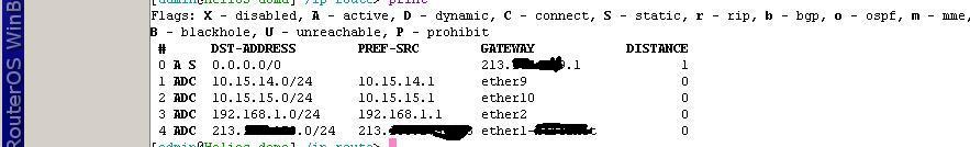

Can you ping respective interfaces IP addresses from servers - 10.15.x.1?
Can you post the routing table from Router?
Routing table from router
