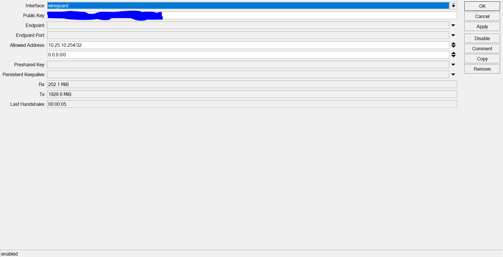

at the moment, when I added 0.0.0.0/0 to the peer used by my computer, the response to ping 10.25.0.3 from my PC is as follows:
Request timed out.

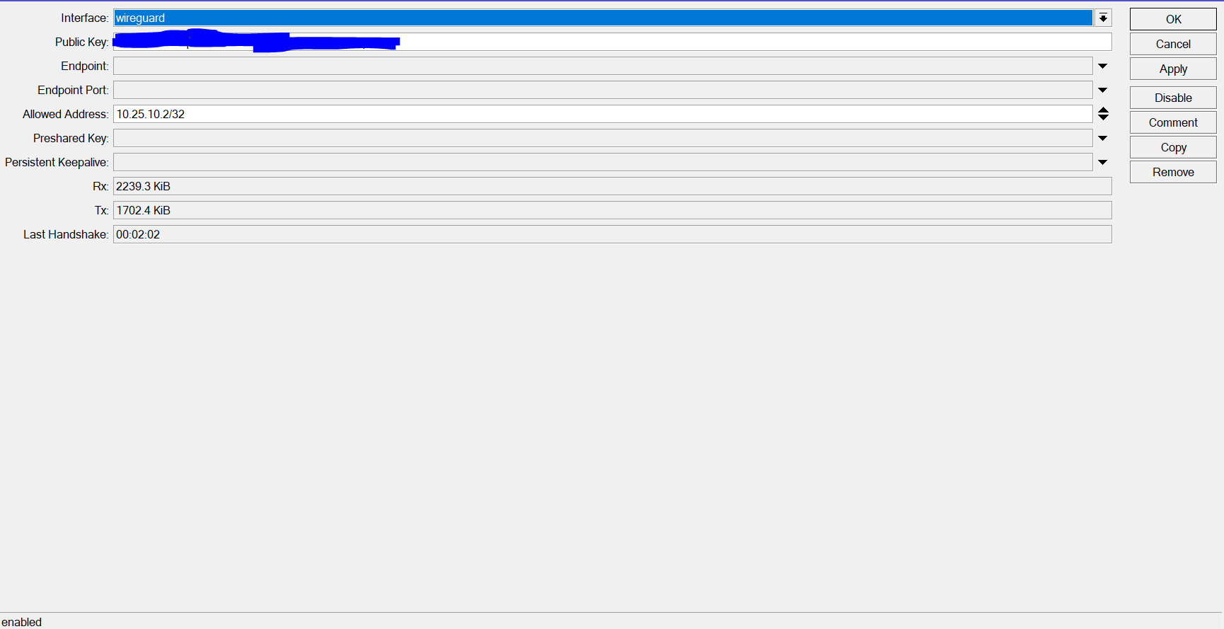

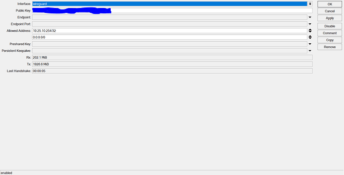

I am also attaching screenshots from the peer from both sides.
Thank you in advance.
Ah, now I see that I didn’t actually set it up on the peer on the server for the client. I tried adding 10.25.0.0/24 to the allowed addresses there and everything seems to work now.
Thank you very much for all the replies.
And you shouldn’t need 0.0.0.0/0 for PC either (for peer on server). Generally be careful with 0.0.0.0/0, it means any address, so only one peer on each WG interface can have that. There can be some overlaps and then it works similar to routes, most specific one will be used. But 0.0.0.0/0 (or any other exactly same subnet) for more than one peer won’t work (it will, but only for one of them).
You are right, I removed 0.0.0.0/0 from my PC’s peer and it still works. Thank you very much for the advice.
