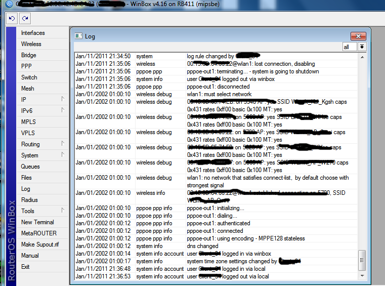

so what does the log say then?

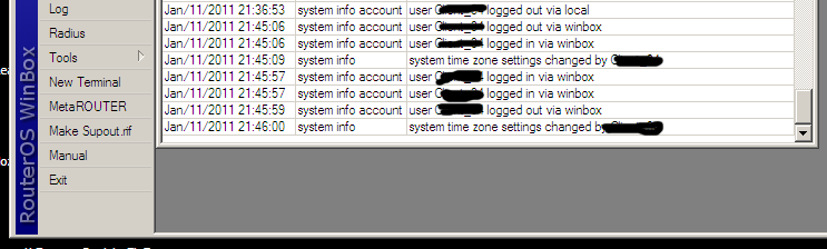

One screen shot using another laptop had no problem with router reboot and from the log has pppoe terminating, wireless debug and available AP’s and pppoe dialing and connection but the other screen shot from the old laptop has logged in and out and no pppoe termination or reconnection?

It’s a been a few months since I last visited this topic but recent network issues has made me recall this issue and the fact remains if a device connected to Mikrotik can prevent a routerboard system function like a simple reboot even though winbox prompts with the normal “router has been disconnected” at the start of reboot cycle and you open winbox (which re-opens instantly normally it would take a minute or longer before router is accessible during a reboot or upgrade reboot cycle?) the function has not completed for example if I had in system packages selected one for uninstall the list would still say “scheduled for disabled” or in files section an a new OS files will still be present and router would not have upgraded,
the logs do not show the incorrect time as is usual when upgrading until the ntp client gets it’s time sync from server, etc.
