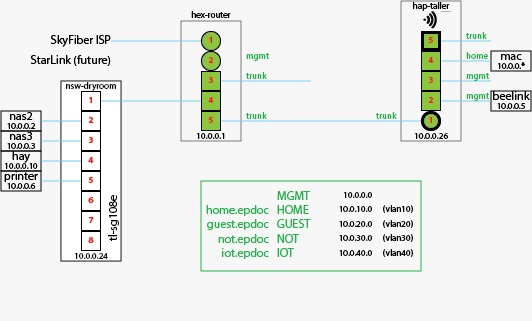

I have a network with a hex-router and a hap ac-lite setup as an AP and switch. I am having difficulties getting my VLANs to work. Configuration files are attached for both these devices, and the network diagram is attached as well.
I have these observations:
  • A windows PC 10.0.0.5 connected to a mgmt access port of hap-taller appears to work fine
  • A Mac connected to a home access port of hap-taller does not work (ethernet or wireless). I cannot ping the AP
  • If the Mac is connected to a mgmt access port and configured with a static IP the connection is flaky
  • I can access the static IP devices connected to the nsw-dryroom switch, including from the PC
  • I have made extensive use of Using RouterOS to VLAN your network http://forum.mikrotik.com/t/using-routeros-to-vlan-your-network/126489/1 and other similar sources. I’ve tried to do all my setup using scripts so that they are reproducible.
This is my first project using VLANs. I’ve been at this for a while and am hoping someone is kind-hearted enough to point out my obvious configuration mistakes. The ultimate goal is to use the VLANs to educate myself regarding networks, partition my smart home devices, video feeds, NAS and other devices, plus a guest network, and to somehow automagically switch between two ISPs to prevent any downtime.
I also find it interesting that I have not found any higher-level configuration panels or tools that can help generate RSC files for multiple devices. I’ve been working on such a tool for myself, using the basic ideas from the RouterOS to VLAN article. But I have to believe someone else has done this too, and I just haven’t found the tool.
hap-taller_20240225.rsc (7.33 KB)
hex-router_20240225.rsc (7.3 KB)

Thanks very much for this reply! There is lots in here for me to process and test out, so it will take a few days (we have visitors at the house).
AP Switch 1 - I didn’t understand well enough to know to do this, even though I’ve seen reference to only adding the one vlan interface.
Router 1 - I thought it made sense to only have static IPs on this subnet. However, that does have the inconvenience of having to set the IP address of any laptop you want to temporarily plug in for mgmt. so yes, thanks for suggesting I simply turn on dhcp, when there is not really a reason to not do so.
Router 6 - some of the rules were for trying to get things to work. thanks for all your comments on these.
Not required, the additional IP address on the offbridge port does not require dhcp-server/dhcp-server network, but thats your call if you want to avoid putting in an IP via iPV4 settings.
I think I have this solved. But I’m not entirely sure. For sure there are a few tweeks still needed. I need more time to learn the monitoring capabilities of RouterOS so that I can manually inspect the traffic (what about unit and integration testing?).
Here’s an updated diagram and the attached RSC files (exported from the devices, and run thru a scrubber). I’ve thrown back in a few subnets that I hid from the original post to reduce the noise. I’ve also renamed the MGMT subnet/VLAN to BASE. I have NOT connected the Ubiquity APs yet.

  1. Based on looking at the diagrams, are you sure the connections to the uNIFI APs are trunks?
    Default setup on them is to be hybrid, expecting vLANBASE untagged and the rest of the data vlans tagged.
    They can be modified to be like other smart APs and receive all vlans tagged ( aka a trunk port ).
  2. Looking at hex this line is missing something or should be removed (/interface bridge vlans)
    add bridge=LAN_BRIDGE tagged=LAN_BRIDGE ??? vlan-ids=50 comment=“traffic tagged 50 (REOLINK) can forward from LAN_BRIDGE”

  1. No I am not sure they are configured to be used on a trunk line. I’ve got them disconnected at the moment, and will experiment with them before bringing them back online. Thanks for the heads up. I’ll be watching for this now.
  2. My idea is to put the Reolink cameras and NVR on their own dedicated switch, then have just one port from that switch to a different, managed switch (not shown) that will tag the traffic with VLAN ID 50. My home assistant instance will want to access the cameras on-demand. And the cameras will all have their own static IP addresses. I don’t know that my idea is a good one. It is also complicated by the fact that a couple of the cameras may end up being too far away to be connected to the dedicated reolink switch.
  3. Agreed. I have an RSC generator that I wrote, and I haven’t removed that yet.
  4. Is there a reason calling it WAN_LIST wouldn’t work, or is this just a preference. The naming is an artifact of my RSC generator, which appends “_LIST” to all lists.
Thanks for the feedback!
  1. Why does HAP T have any ports for UNIFI, your diagram shows them on the HAP B ???
  2. Your HAP B bridge port for unifi are wrong!!
    If the mangement port is base vlan then that is the vlan 99 that should be pvid to the unifi (hybrid port with management subnet untagged)
    If the unifi is setup so that it accept all vlans tagged (incl management vlan) then its a trunk port and no pvid ).
    no preference only, really should have said only need one WAN list, name doesnt matter
There is a unifi.myhouse ssid that is for legacy devices on my old network (192.169.1.0). This is different from the trunk ports to the two unifi APs. I hope to get those devices migrated over and close this ssid down.
