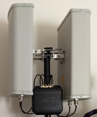

I not have the equipment that you mention, but if you check on my signature, you will can see that I have. Really good experience with my devices.
Check It if for you can be an alternative.
About ROS 7 compatibility I not know.
Regards.
interesting the two sectional antennas (are they pcb? ) what brand are they, are there antennas for the 4 x 4 mimo in one panel? For lte management on LR8 LTE what version do you have of os router and what modem card do you have.
