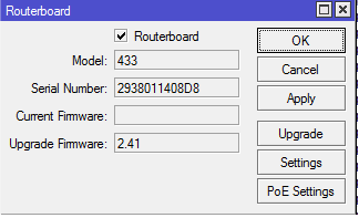

Picture shows what its doing, does not show Current Firmware, only upgrade firmware
You have NO current firmware. It causes kernel failure.
Try:
/system routerboard upgrade
I tried that a few times allready, it just loses the firmware

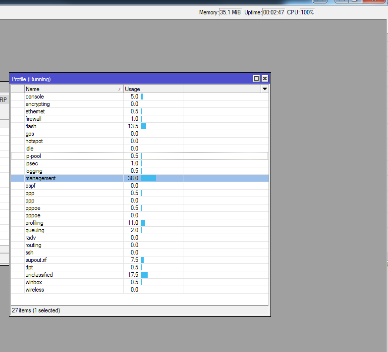

Happened again, look at the profile. I am not running SNMP,usage just spikes to 100% by “Management”

I dont know what couses it, but sometimes helps:
/system routerboard settings set force-backup-booter=no
/system reboot
