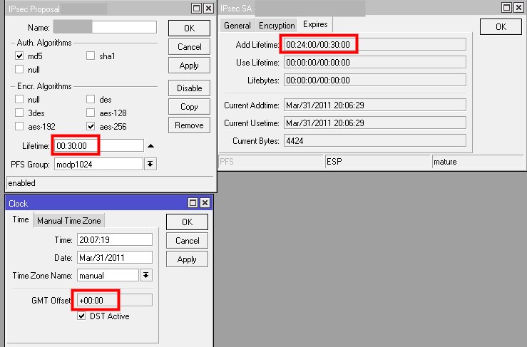

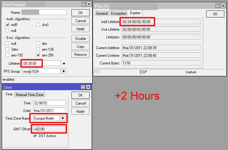

there is a SA Lifetime Bug in V5, where the Timezone +2 Hours is added to the time, so a DPD will not work.
Regards Michael
