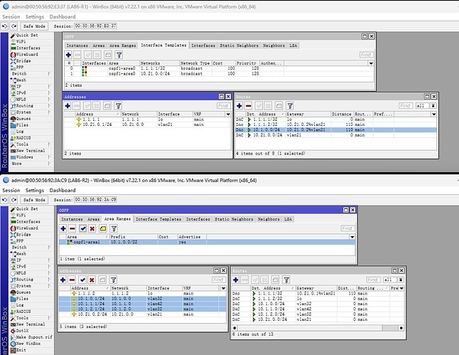

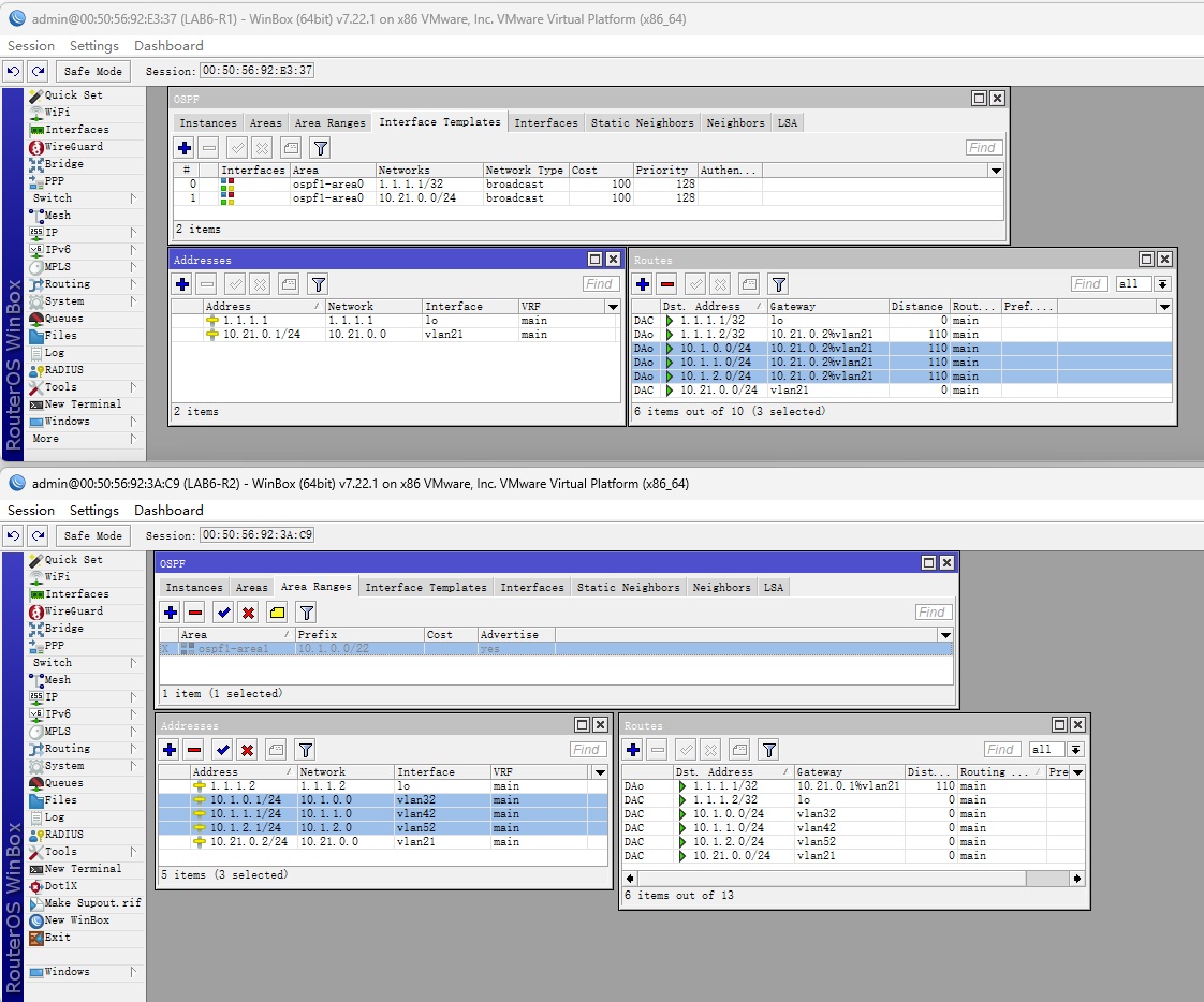

I reproduced this bug using 7.22.1
Subrouting 10.1.0.1/24, 10.1.1.1/24, 10.1.2.1/24
After summarizing the routing according to 10.1.0.0/22, the neighbors learned not 10.1.0.0/22, but 10.1.0.1/24

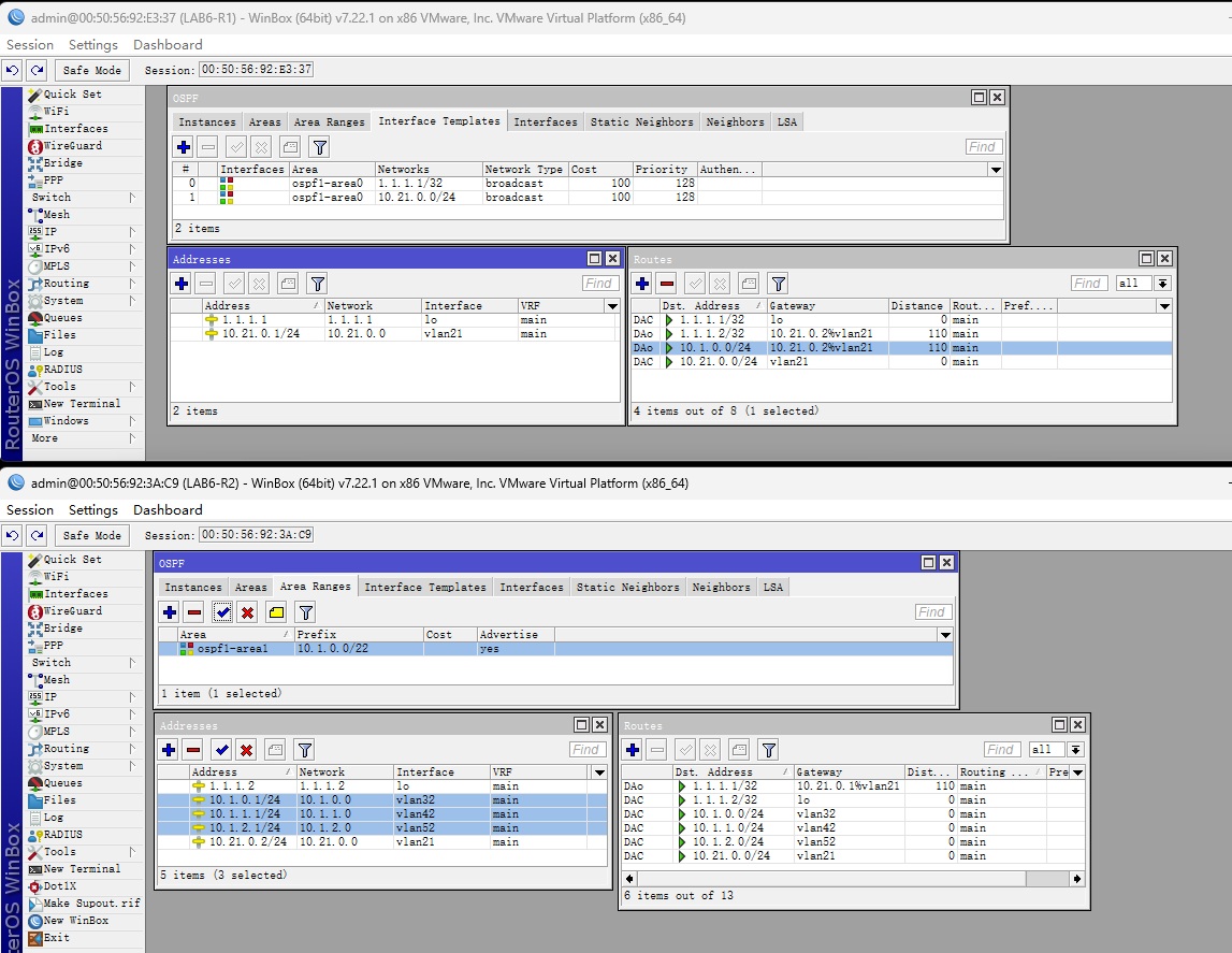

7.23.1 is the same
reboot the instance of ospf , it will be ok ,but when you add a new area range , you need reboot ospf again...
