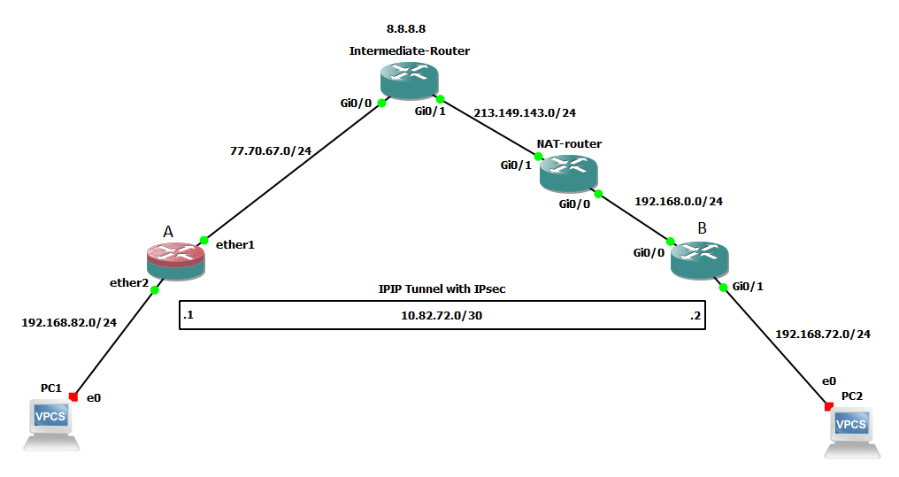

I have been struggling for the past couple of days with a reletively simple setup. It didn’t work, so I have decided to emulate it in GNS3. Sure enough I’ve got the same result like in the real network. So here’s the situation
  1. A Cisco router behind a NAT device
  2. A Mikrotik router (emulated with CHR image version 6.39.2) which has a public IP configured directly on it’s WAN interface
  3. Both routers are configured with an IPIP tunnel between them. Topology attached
  4. NAT is not an issue as I could see the IPsec signalling packets back and forth. I could also see not only udp port 500 but also udp port 4500 being opened on the NAT router - which means the NAT-T mechanism works. Which is also evident in the logs (attached).

My understanding is that when I use tunnel mode I need to specify the private subnet behind the NAT. And that’s what I do, 192.168.0.0/24 is the subnet behind the remote NAT and it’s the network the Cisco IOS router initiates the IPsec from.
The RouterOS has the public IP address directly configured on it’s interface so that’s why I have it also specified as a src-address.
I’m still clueless what exactly I’m missing…
