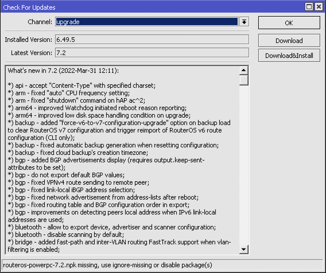

routeros-powerpc-7.2.npk missing in the upgrade channel ...
This one seems to get lost in the announce channel, so I created this separate post.
Trying to upgrade my test RB1100 to 7.2 …
routeros-powerpc-7.2.npk missing in the upgrade channel …
Anyone got this working ?

When did you try this last? We fixed it yesterday
Hi @normis
I checked about 5min ago (10:00 CEST) and stil get the same error …
RB1100 is looking for routeros-powerpc-7.2.npk
while there only seems to be a routeros-7.2-ppc.npk in the download section
I’m seeing the same thing on a RB1100ahx2
tried again at 14:00 CEST, stil the same error
You can always download manually and drop it in Files. Reboot and the upgrade will be done.

RB1200
same issue
            channel: upgrade
  installed-version: 6.49.6
     latest-version: 7.2.1
             status: routeros-powerpc-7.2.1.npk missing, use ignore-missing or disable package(s)
system routerboard pr
       routerboard: yes
             model: 1200
     serial-number: 2E320285D9A6
     firmware-type: amcc460
  factory-firmware: 2.37
  current-firmware: 6.49.6
  upgrade-firmware: 6.49.6
The naming between v6/v7 is changed, wanted or not
download manually
https://download.mikrotik.com/routeros/7.2.1/routeros-7.2.1-ppc.npk
or by fetch
/tool fetch url="https://download.mikrotik.com/routeros/7.2.1/routeros-7.2.1-ppc.npk"

The point made is that this needs to be solved in the tools which check for package updates.
My view:
It is not smart to perform a name change on a package which needs to be fetched with a predefined name by tools responsible for updates before that same tool has been modified to get the new name.
At least provide a symlink to the old name so everything keeps working !!

In the mean time I did a manual upgrade by dropping the 7.x version in the files section and rebooting the 1100.
No problems whatsoever, everything works fine, firmware upgrade also without problems.

On v7 is changed the filename from all platform:
from v6
download.mikrotik.com/routeros//routeros--.npk
is only the version number without text like “6.48.6” but not “6.48.6 long-term”
can be arm, arm64, mipsbe, mmips, smips, tile, powerpc, x86
to v7 architecture and version number are swapped
is only the version number without text like “7.2.1” but not “7.2.1 stable”
can be arm, arm64, mipsbe, mmips, smips, tile, ppc, NOT x86 because only without “-” specified is for x86
or by fetch
/tool fetch url=“https://download.mikrotik.com/routeros/7.2.1/routeros-7.2.1-ppc.npk
