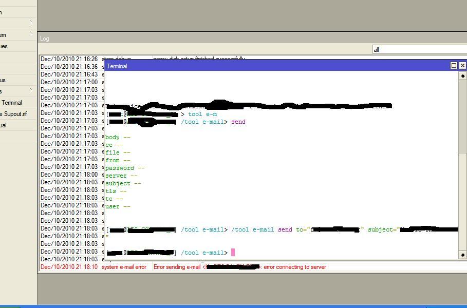

Mikrotik v5.0 RC5 cannot send email.
ROS on x86 + Core 2 Duo + RAM 2GB.
Which v5.x can send email ? I have to use send mail for my SLA monitoring.
