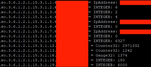

After doing a snmpwalk on 1.3.6.1.2.1.15, RouterOS v7.11.2 only reports the following:
mibs.observium.org/mib/BGP4-MIB/#bgpLocalAs

Your comment: attached bgp snmpwalk output
Reply: really? this is full output for BGP4-MIB?.. Here only basic peer information, but while unknown LocalAS - it doesn’t make sense.
My conclusion is RouterOS v7.10-7.11.2 bgp snmp support is very limited, most SNMP monitoring tools wont work out of the box without manually pulling custom OIDs. Will wait till RouterOS v7 includes more OIDs for BGP to show up in Observium.
