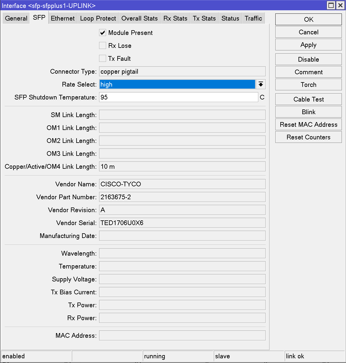

Picture of the cable data in attachment from version 6.49.15. I can also send any additional information, maybe even experiment at night with what RouterOS version will be the last to recognize the cable correctly.
