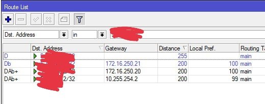

Observed behavior on CHR
For a single prefix (example: 192.168.1.1/32), three iBGP routes exist:
Route A: LOCAL_PREF 100 → inactive
Route B: LOCAL_PREF 100 → active (ECMP)
Route C: LOCAL_PREF 99 → active (ECMP)
So:
Two routes are installed as ECMP
These two routes have different LOCAL_PREF values
One route with the same LOCAL_PREF as an active route is excluded
This means ECMP is created:
Not only without equal LOCAL_PREF
But also inconsistently across otherwise identical routes

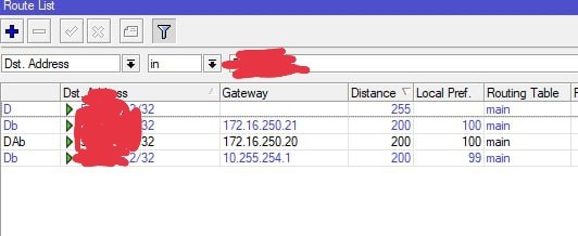

Observed behavior on CCR1036
With the same RouterOS version and configuration:
Only one best path is installed
No ECMP occurs

first one on chr 7.20.6 second one on CCR1063 7.20.6
