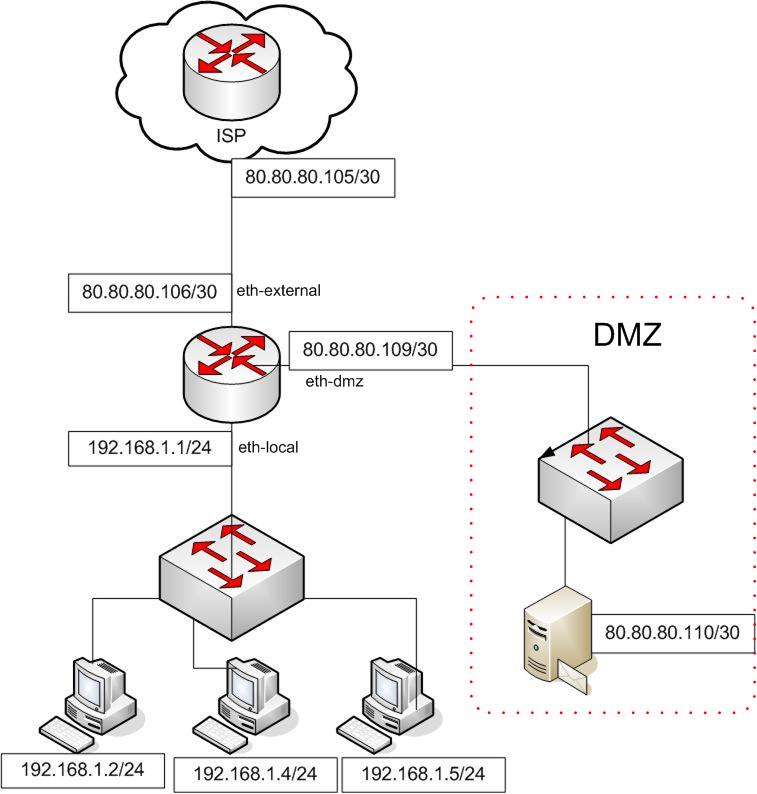

I try to make connection between DMZ server, with public address, and LAN computers.
When I ping public adress 80.80.80.110 FROM local area computer, all works fine.
But if I try ping from DMZ servers (80.80.80.110) to local TO local area network computer “Request time out”.
What’s wrong? All networks are direct connected to router?
Scheme is attached
Routing table look like this:
DST-ADDRESS PREF-SRC GATEWAY-STATE GATEWAY DISTANCE INTERFACE
0 A S ;;; added by setup
0.0.0.0/0 reachable 80.80.80.105 1 external
1 ADC 192.168.1.0/24 192.168.1.1 0 local
2 ADC 80.80.80.104/30 80.80.80.106 0 external
3 ADC 80.80.80.108/30 80.80.80.109 0 dmz
Note: LAN computers not firewolling

I mean ICMP packages are not block by host firewall.
In general, on router firewall rules not set and on hosts firewall is not started, all ICMP packages must be routed by ruoter and accepted by hosts, but this is not happen.
I want to clarify if router make forward packages from DMZ (with public IP) to LAN (with private IP), direct without NAT-ing?
Both networks are direct connected to router through eth-local and eth-dmz interfaces.
I know from theory routers not forward packages with private IP sourse address through default route, but I don’t understand why packages doesn’t forward between two direct connected networks (one with public IP-s and other with private IP-s).
