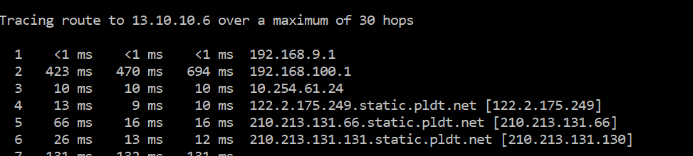

I’m facing the same problem but the difference is a firewall is enabled and NAT too. I can ping and access everything from LAN to WAN but can only ping and access Mikrotik IP address from WAN side.
Here is my setup:
USG:
Internet: 192.168.100.3/24
LAN : 20.10.10.0/24
VLAN : 192.168.1.0/24
VLAN : 192.168.9.0/24------------------------->Mikrotik:
…Internet: 192.168.9.135/24
…Lan: 192.168.1.0/24
…VLAN: 10.13.10.0/28
… VLAN: 10.10.10.0/25
You might be wondering what’s with the IP’s but I’m in the situation where I can’t change cause it will cause bigger problems. So for the meantime, I want to try to solve this first.
The thing is, I want to access the VLAN 10.13.10.0/28 from the USG side(WAN). When I try to ping it: REQUEST TIME OUT
I tried tracert from WAN side and here is the result:
Can somebody please point me what could be missing?
Your help would be really much appreciated, Thank you so much.
You’re missing a route on USG. I don’t know the syntax, but on ROS it would be something like:
add dst-address=13.10.10.0/28 gateway=192.168.9.135
I’ll just dismiss the fact that 13.0.0.0/8 is a public routable address block and in principle you can’t use it locally (unless you actually got subnet of it assigned to you from ARIN).
@ mkx,
Thanks! I can now access them.
And your right, it should be 10.13.10.0/28. Thanks again for pointing it out :slight_smile:
