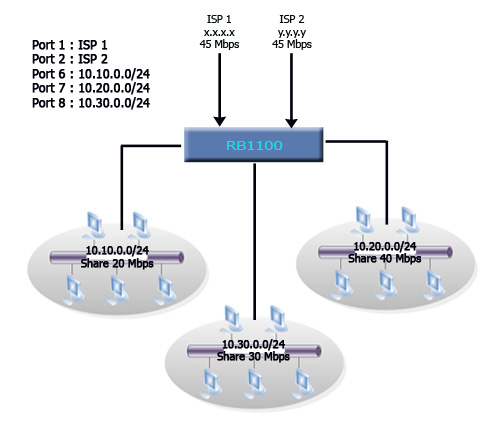

sir, here is the diagram. the network must have fail over support on load balancing.
please.. really new to mikrotik. thanks!
Right. That’s covered in the manual:
http://wiki.mikrotik.com/wiki/Manual:PCC
http://wiki.mikrotik.com/wiki/Manual:Queue#Simple_Queues
If you need someone to write an entire config for you it is probably best to hire a consultant.

sorry about that! i mean refer to the diagram.
say for example base on the diagram, if each port will have an average of 200 user (thats 600 user total), will RB1100 still handle it?
Probably - as long as you don’t configure lots of inefficient rules, like I mentioned.
