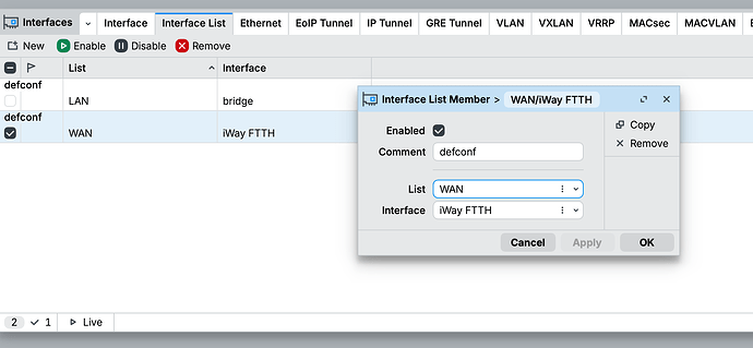

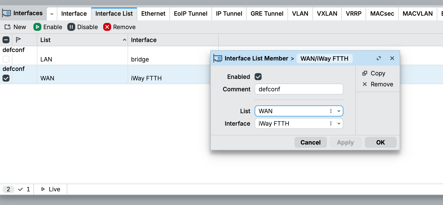

I don’t see this in my config. Would you mind sharing the Terminal command to add this or how and where to set this in the Winbox GUI?
Cheers!
The code posted IS the terminal command to use.
You have now in your configuration (it is the default):
This means loosely:
  1. put interface "bridge" into group "LAN"
  2. put interface "ether1" into group "WAN"
Your interface "sfp-sfpplus1" is member of the bridge:
add bridge=bridge comment=defconf interface=ether6
add bridge=bridge comment=defconf interface=ether7
add bridge=bridge comment=defconf interface=ether8
add bridge=bridge comment=defconf interface=sfp-sfpplus1
You added a VLAN interface:
/interface vlan
add interface=sfp-sfpplus1 name="iWay FTTH" vlan-id=10
on top of it, this interface cannot evidently have been set among either LAN or WAN.
BUT it NEEDS to be categorized as WAN, otherwise firewall filter and nat settings won't apply to it.
So simply run in terminal (you can copy/paste the following):
add comment=myconf interface="iWay FTTH" list=WAN
But I believe you should also remove the sfp-sfpplus1 underlying interface from the bridge (this is easier in GUI) on terminal:
remove [ find interface=sfp-sfpplus1 ]
THIS IS IT. This is the setting that makes it work. Easy to find, once you know it. Thank you so much everyone.
You should change the comment from "defconf" to "myconf" (or whatever you prefer) so that checking the configuration in the future will more evidently show the change.
At this point, your ether1 Is neither LAN nor WAN and not part of the bridge.
You can either add It to bridge or make it an off bridge port (an emergency access), instructions here:
Once and for all COMPLETE Offbridge Port setup
As a final note: When serving internet via the SFP port instead of Ethernet port 1 (ether1), then ether1 is not part of the bridge by default. ether1 needs to be added to the bridge in order to make it part of the LAN setup.
