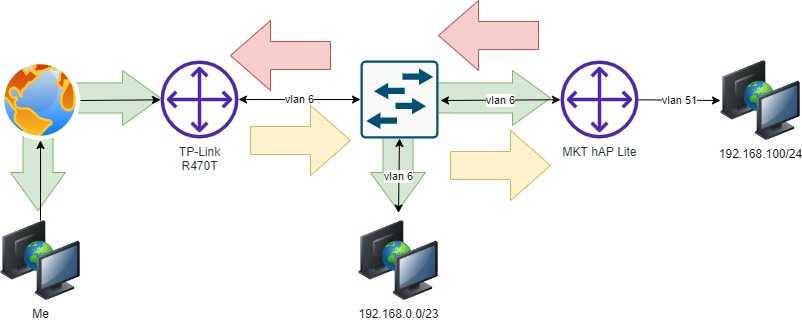

I have this setup:
A TP-Link router as a gateway00 for my main LAN00, and the hAP lite as a gateway01 for the another LAN01 that is WiFi only.
The hAP is BEHIND the TP-Link, yes, is it a double nat, but the TP-Link does not have the advanced functions, like vlan handling and multi-addressing to handle several networks.
What I want to do is use the hAP to forward specific traffic or ports to one specific machine on the LAN00 again. I know, the TP-Link can do it that BUT, the thing is that I want the hAP to use the src-address list to allow just certain machines that come from the internet to access that specific machine in LAN00.
So, the the hAP that is behind the TP-Link will act as a gatekeeper with the src-address list forwarding just specific traffic or ports to that specific machine on the Lan00
I know, that it can be also done via vlans, but I would like to know how messed up this way would be.
In short (with diagram), Me, will be coming from the internet, the TP-Link will have a port forward pointed to the hAP that is behind, and I want the hAP to forward or route the traffic to an specific machine that is int he TP-Link LAN, which is also the WAN side of the hAP.
Quick and simple solution is to use variant of harpin NAT, i.e. dstnat from hAP to target machine and srcnat to change source to hAP’s address, to make target machine send responses back to hAP and not to TP-Link as its default gateway. Downside is that target machine won’t be able to see original source addresses, everything will look like it’s coming from hAP.
There may be other options, depending on how much configurable is target device and how much it needs to be part of 192.168.0.0/23 subnet.
The target would be a windows machine, before I had an access list on the windows firewall but I was like “meh… if I want to add another machine, I need to repeat the same setup again in that machine”.
Then I remembered that I had the hAP lite on the network and I was like “…I wonder if…”
But your solution could be exactly what I need.
Edit: How do I do what you said?
If you have default firewall, then just dstnat should be enough, e.g.:
add chain=dstnat dst-address=192.168.h.h protocol=tcp dst-port=80 action=dst-nat to-addresses=192.168.m.m
where 192.168.h.h is hAP’s address in 192.168.0.0/23 subnet and 192.168.m.m is target machine. You can additionally exclude local connections, in case you need to be able to connect to given ports on hAP itself (192.168.h.h) from local subnets, using src-address=!192.168.0.0/16 (“!” means “not”). The srcnat part should be covered by default masquerade rule, but otherwise it would be:
add chain=srcnat dst-address=192.168.m.m protocol=tcp dst-port=80 action=srcnat to-addresses=192.168.h.h
Possibly with src-address=!192.168.0.0/16 to again exclude local traffic (direct connections to 192.168.m.m from subnet behind hAP).
So, I will use this if I had the default masquerada rule, which I do:
If not, I need to add this also so it works in pairs for the traffic to flow.

It can be any srcnat rule that applies to this forwarded traffic.
This one with specific address and port is minimal version that shows only what’s required, and tries to not touch other traffic. For example, if you didn’t have NAT on hAP and subnet behind it was known to TP-Link (it would have route to it), you’d be connecting from there to machine’s other ports, and you’d want to keep original source addresses, then you’d need srcnat rule that doesn’t mess that up. This one would still affect connections to port 80, but it could be prevented with additional src-address=!192.168.0.0/16.
If you have masquerade, where only condition is outgoing interface, it covers it too. And also everything else from hAP’s subnet, but since that’s intentional, everything is fine.
