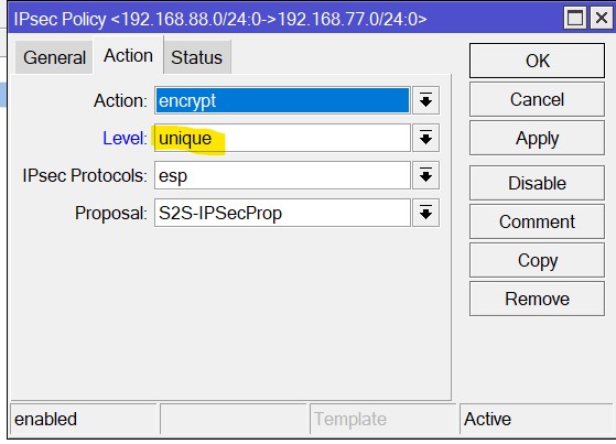

If you have plain IPSec, then what goes in tunnel is controlled by policies and it’s not very flexible. Let’s say you want to tunnel traffic to internet from 192.168.77.100, for that you’d need policy for 192.168.77.100/32 ↔ 0.0.0.0/0 (use level=unique for all), but it’s just like that, static with no easy exceptions. If that’s ok, good.
If not and you’d rather have something more dynamic, then instead of plain IPSec you can use IPIP tunnel, use IPSec to encrypt only that, and the tunnel itself is then regular interface and you can do whatever you want with it.
Are you talking about Policy based Routing (Firewall >Mangle) or IPsec Policy?
If you talked about IPsec Policy, is that how you suggest should be configured?
You’re in right place. But Dst. Address 192.168.88.0/24 allows only this subnet as destinatination. If you want access to whole internet, you need 0.0.0.0/0 as destination.
Hey,
Thank you for a help. I did as you suggested. Source is only 192.168.77.100/32 , Destination 0.0.0.0/0 and on the main site Source 0.0.0.0/0 and Destination 192.168.77.100/32.
Unfortunatelly I cannot test if this setting is now properly routing all traffic from 192.168.77.100 via 192.168.88.1 GW as device on a remote site is offline.
Perhaps there is other way to test it?
Just on more thing. Is this really all you have to do in order to route all traffic from that device via 192.168.88.1 GW?

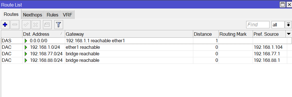

Now I just have a chance to test it and it is not working.
If I add static ip address of 192.168.77.100 i dont have access to internet.
Traceroute goes to 192.168.77.1 and after that unresolvable.
If I choose any other address from that network, I am able to access internet, but of course from that network.
Is there missing route entry for that particullar IP?
No, IPSec doesn’t care much about routes, it just takes all packets that match policy. You’ll have to check what exactly happens, if packets pass through tunnel and reach the other router. E.g. with logging rule there:
