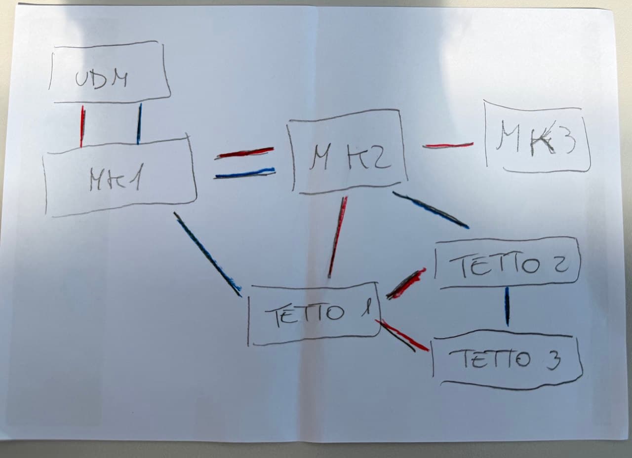

Hello, I have this network topology:
I am trying to adjust the RSTP protocol, which I initially left with the default parameters
The red line is the main path
The blue lines are all the backup path
I have three routers (one of which is the main router that manages) connected to each other, a gateway for internet access, and a connection to the roof where there is a router that manages routes to the outside of the network and two others that act more or less as switches
I have currently adjusted the priority of the bridges to elect MK1 as the root bridge and adjusted the priority of the ports to obtain the path I have set as the main one... but if I close the ports, I can't adjust the backup path properly...
Can you help me?
Thanks in advance.
EDIT: One more thing... but would it be better practice to bond the interfaces where possible? Or is RSTP better?
Translated with DeepL.com (free version)
RSTP is generally fine to use for fail-over purposes. It’s sometimes seen as old and outdated technology, but actually e.g. Siemens advocates for it’s usage in several papers quite strongly (mainly for industrial control systems) - it’s widely supported, compatible with everything, and well, just works. There’s nothing wrong with that.
The case with RSTP however is that it can’t “just be enabled” and magically do the right thing - it actually has to be configured correctly. Luckily configuring it is really simple.
The first thing to look out for is to select the same short/long mode for all participants. The choice is usually long.
As you have alluded to, priorities have to be set up. It’s important to know that, although Mikrotik will accept them, not all priority values are actually valid. See the official documentation for a description.
Just a pro-tip: actually read the official documentation cover-to-cover. It’s actually really well written. Then read it again and again until you understand it completely.
Setting up priorities can be done in two ways: with the bridge priorities and per-port. Use priorities whenever possible. (In your case it’s not only possible but preferred.) Your intended default path distribution actually differs from the default on many points, so you’ll probably have to set the priorities on MK1, MK2 and TETTO1.
As to whether to prefer bonding (I presume in backup mode) is a matter of preference. If you’re using RSTP anyway, I’d use that - but this is just my preference.
One little fact is that MT currently doesn’t support setting hello timers. This is an omission. This means that until this is added, LACP backup (with properly set timers) will give you faster recovery than RSTP in case of non-link-layer detectable faults (such as through a typical media converter.)
If on the parallel (“bonded”) connection you choose to use RSTP and you have equal speeds involved and you have some preference as to which should be the primary, then you’ll have to adjust port costs.
