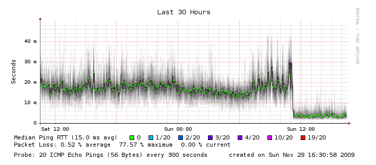

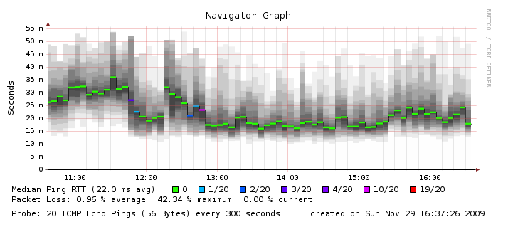

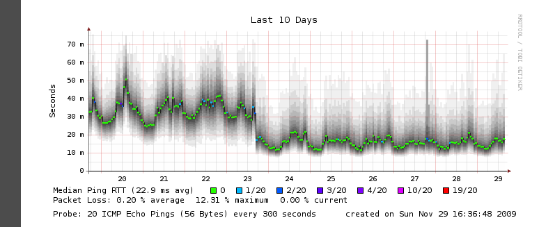

I thought i would share my real world experience with enabling RTS/CTS and tweaking hardware retries.
We have a mix of about 500 Mikrotik CPE and 50 or so base stations all running between 2.9.51 and 3.10 +
Some of our sites have 30 + customers coming off one radio, and we would see average latency (idle) of about 20/30ms. We offer plans that start at 3mbit/sec so the need for throughput is quite high.
I recently read on the forums that RTS/CTS would improve things quite drastically, but only if you install it on the AP + client - so, i set about installing it on both. Below are some smoke ping graphs from 3 seperate customer sites to give you an idea of the difference - its impressive!
Throughput is definately improved as well - site 2 can acheive 9.7mbit/sec download and 9mbit/sec upload on the same sector as 31 other customers - and this is in a 10mhz channel.

Thanks for that - but i do want to know, what (in your educated opinion) has attributed to the increase in throughput and significant decrease in latency?
When you say “RTS on the AP should be set to the highest level possible aka not at all” - what do you mean?
My understanding was that RTS / CTS was ‘ready to send, clear to send’ - i.e, the client requests to send and the AP broadcasts ‘clear to send’ to all stations, indicating that other stations cannot send until the requester has completed sending.
Furthermore - 3.30 + Wireless beta is the only current version (other than 4.x) that has the RTS/CTS implimented - of course, correct me if i’m wrong.
Finally, our entire network (as per my post) is running nstream with polling - the smokeping graphs were after implimenting RTS/CTS AS WELL AS nstream - you can see the difference yourself :slight_smile:
Thanks!
