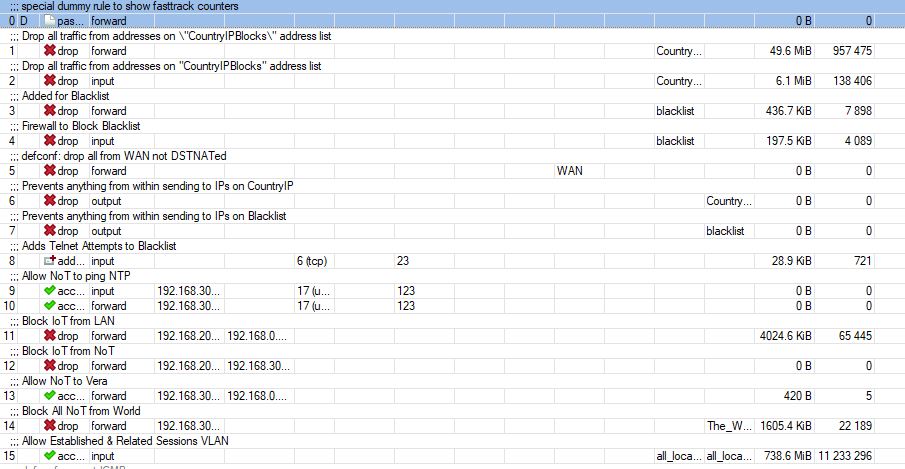

I implemented the above, but dont seem to be capable of passing traffic over 123. I attached a screen capture of the rules in my MT.
Appreciate your review.
jwb

Rules are processed in order from top to bottom. So when #9 and #10 have no hits, either the traffic is blocked by previous rules, or nothing from 192.168.30.0/24 sends such packets for some reason.
My testing was with a couple of android atomic clock apps, and wasn’t able to pass. I’ll dive a little deeper into it. I did move the NTP rules to the 1 & 2 position for testing.
I’ll look for an app that lets me dictate where I want the test to run (by IP/port) The ones I tested had pre-configured servers..
