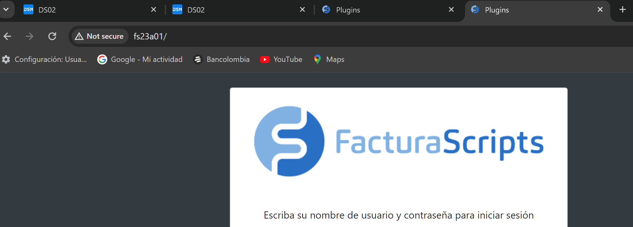

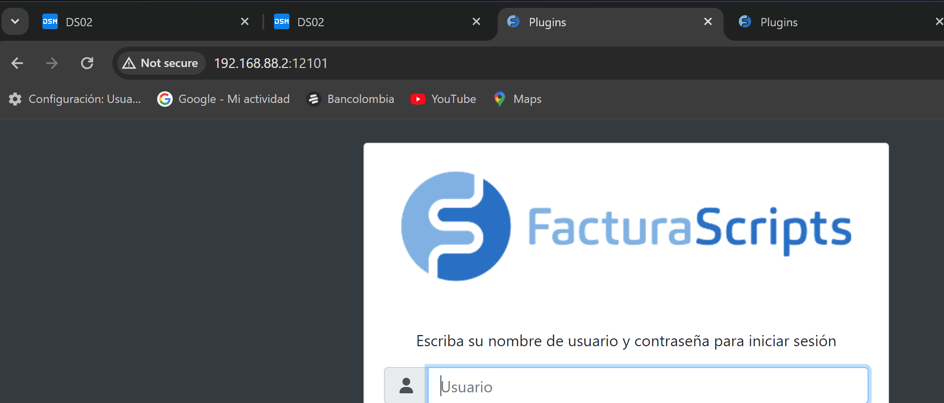

This docker app does have a hostname on the Synology so when on the local LAN I can start the app both writing on the browser the Synology LAN ip and the docker app designated port OR just write on the browser the hostname. For example on this scenario I write on browser http://192.168.88.2:12101 or http://fs23a01 and then in both cases I can run the same docker app.

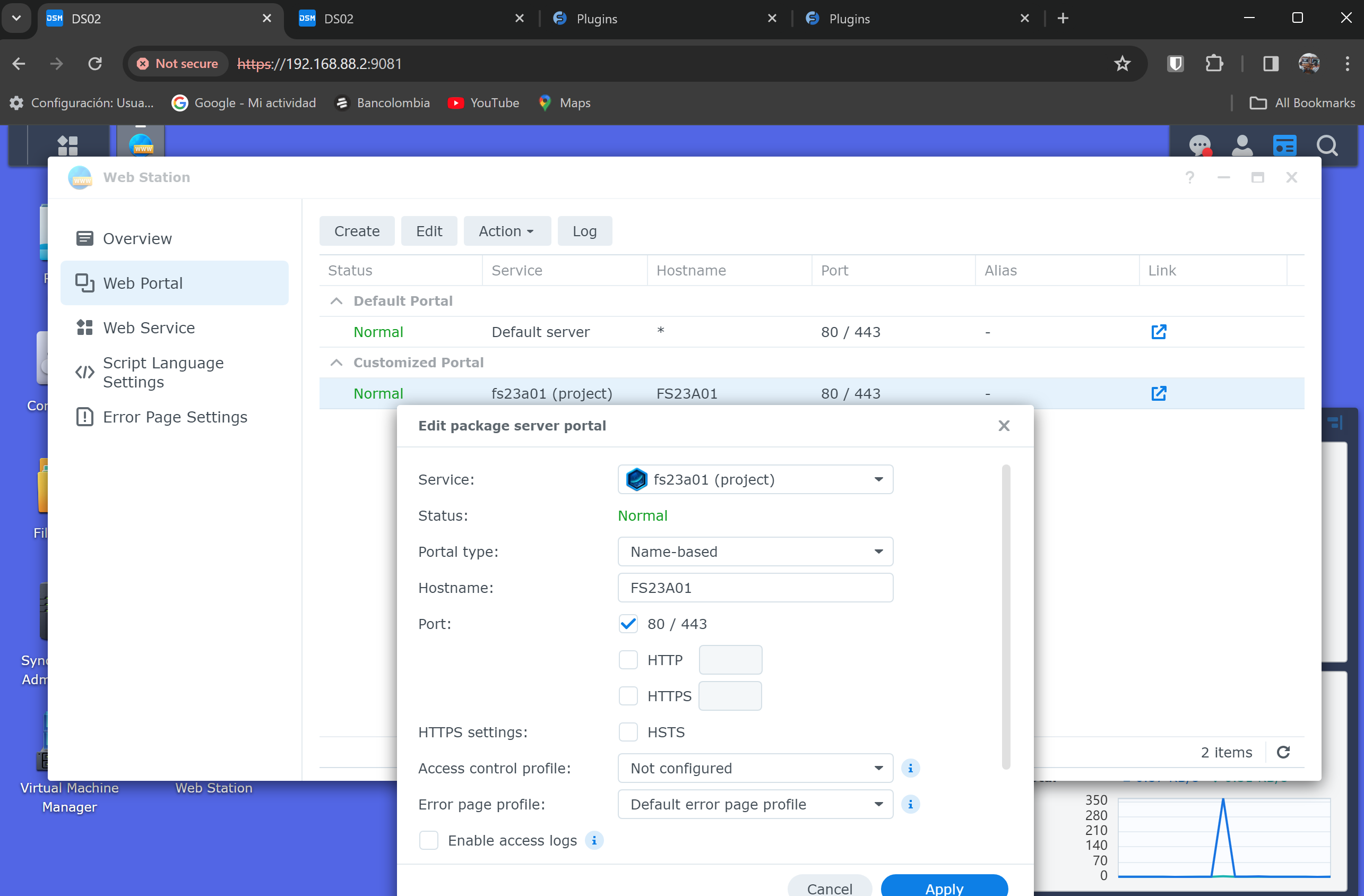

This docker hostname has been setup on the Synology NAS web station add-on package:https://www.synology.com/en-global/dsm/packages/WebStation

Synology NAS hostname config
Docker app from hostname (local only)
Docker app from LAN

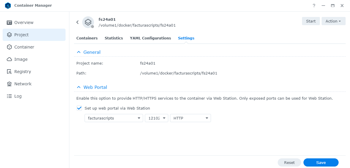

  1. On the Synology NAS, once created the container and checked that it runs whit no issues, then stop the container proyect and on Container Manager / Proyect / Settings / Web Portal, check this option and configure the 3 related boxes whit the default name of the proyect, port, and chose if http or https (I use http because the only way to access this container is from WireGuard), then restart the proyect.

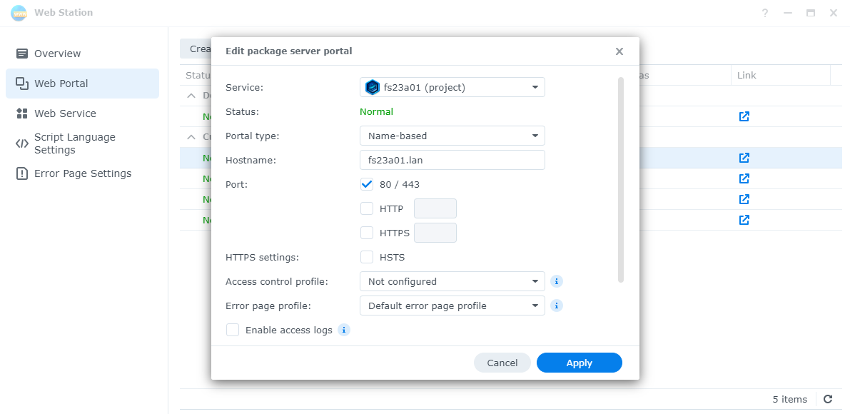

  2. Continue on the NAS and go to app Web Station / Web Service, and there select the desider customized portal to configure it as the screen capture below.

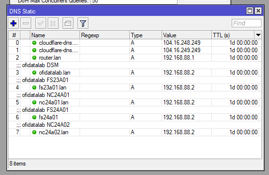

  3. Then on the MK router open WinBox and go to IP / DNS / Static and there add the hostnames created on the Synology NAS as showed on the capture below.
  4. On the WireGuard peer configuration add on the Interface DNS the ip of your MK router.
