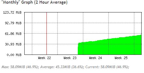

run script and memory leak
I write a script and I observed memory leak
Would you check where is mistake
This script should double the transfer between 24:00 and 12:00. I have a ppp users that login and SQ is take from radius. I must check SQ every few minutes because my users login on difference time on the day.

I can confirm a memory leak in a simple command:
/queue simple disable [/queue simple find ]
Background: RB1100AH, ROS v5.16 running as PPPoE server with dynamic simple queues set up by FreeRADIUS Mikrotik-Rate-Limit attribute, currently a little over 200 customers connected. I’m recently testing “unlimited” bandwidth at night, the above command is run every minute between 0:00 and 8:00 (to catch any new connections during that time - would have been better to run a script triggered by new PPPoE interface up, but I don’t know how to do that), then at 8:00 the “disable all queues every minute” scheduled task is disabled and all queues are re-enabled again for the day. Looking at memory usage graphs, it increased by about 400 MiB in a week, and only rises during the night hours when the disable command runs every minute. It can also be reproduced by just running the command several times from the command line, alternated with “/system resource print”. I’ve found a simple workaround - use
/queue simple disable [/queue simple find disabled=no ]
so that only enabled queues are disabled, this removes the leak or at least reduces it to manageable level (it won’t exhaust the whole 1.5GB of RAM in a few weeks). I still think there is a bug - disabling an already disabled queue should simply do nothing, not eat memory.
I worked it out from memory leak. write the script which check memory status and, if necessary, reset the system.
In all versions I install memory is leak
I suspect that the reason is switching simple queue limit
