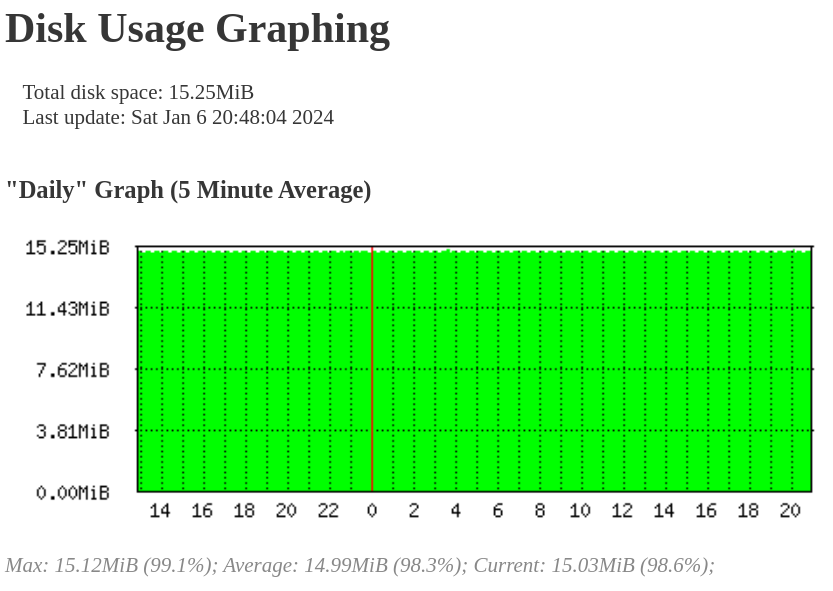

My HAP ac2 running on 7.13 is about to run out of space. Is Mikrotik aware of that? Maybe it would be a good idea to exclude ppp and routing from the main package bundle?
This was discovered long ago (as soon as 7.13 came out). I certainly hope MT reads the comments in release topic they created themselves … and I hope will do something about it.
Beware that when space runs out, you won’t be able to change configuration. And device might become unstable (rebooting for no actual reason). Or anything else.
It seems that the hAP ac2 is the most affected by this problem.

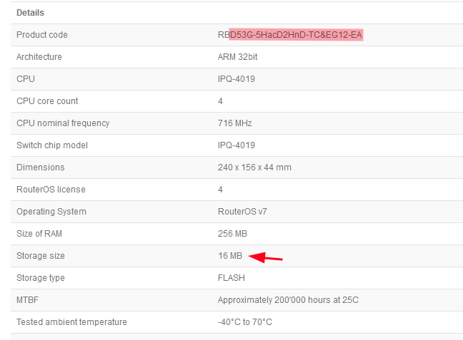

D53G-5HacD2HnD is having the same issue - only 596 KiB reported free after upgrading to v7.13, total storage is 15.3MiB, on the MT’s Product page on website its showing MB

@t0mm13b https://www.gbmb.org/mb-to-mib Afaik any storage device is advertised in MB/GB/TB sizes, not in MiB/GiB/TiB.
That is wrong. Internal memory is in MB but “external” storage like flash is always in MiB.
When you buy a “16MB flash card” it will be 16000000000 bytes, not 17179869184.
That would make it 14.9MB instead of 16MB.
However, that is all that is going on here. As mentioned, the hAP ac2 reports less space than all the other 16MB models.
