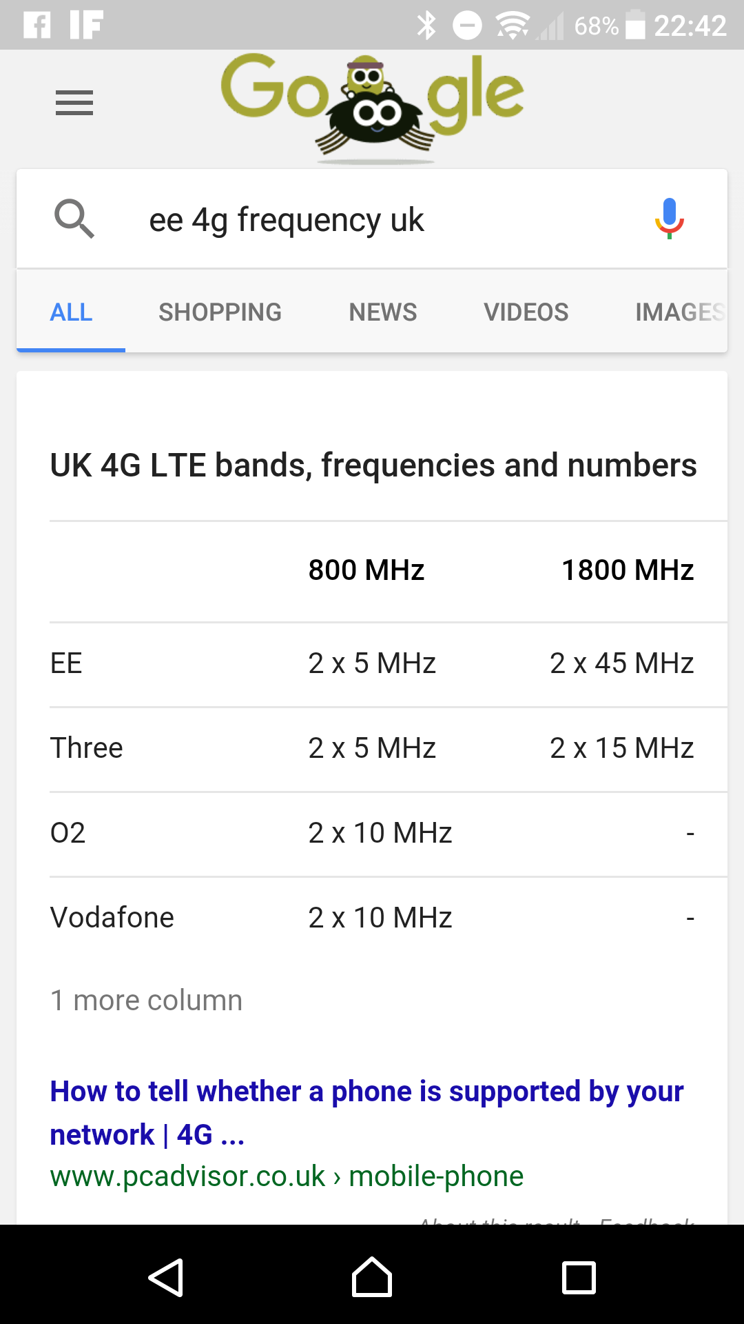

Just check that you have 4g coverage on the frequencies supported by the SXT LTE. 800 MHz is not supported, and this is the 4g band with best coverage in rural areas.
Good point, my provider would be ee.
