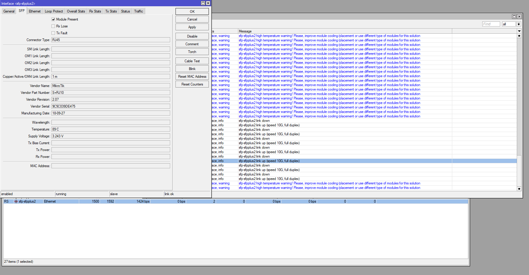

I have S+RJ10 and CRS326-24G-25+RM products. Although the 10g module is not used, its temperature rises and turns itself off for 10 minutes. It turns off again about 16 minutes after it is turned on. it goes on like this all the time. The interesting thing is that I removed this port from network use because of these breaks, only its cable is plugged in.

S+RJ10 unfortunally gets insanley hot. 89 degress is just way to hot to function properly.
Last summer, when it got close to 40C around here, the two S+RJ10s I have in use (one in a CRS309 and another in a RB4011, both passively cooled devices) reached 100C and lived to tell the tale. They didn’t even switch off; just soldiered on.
