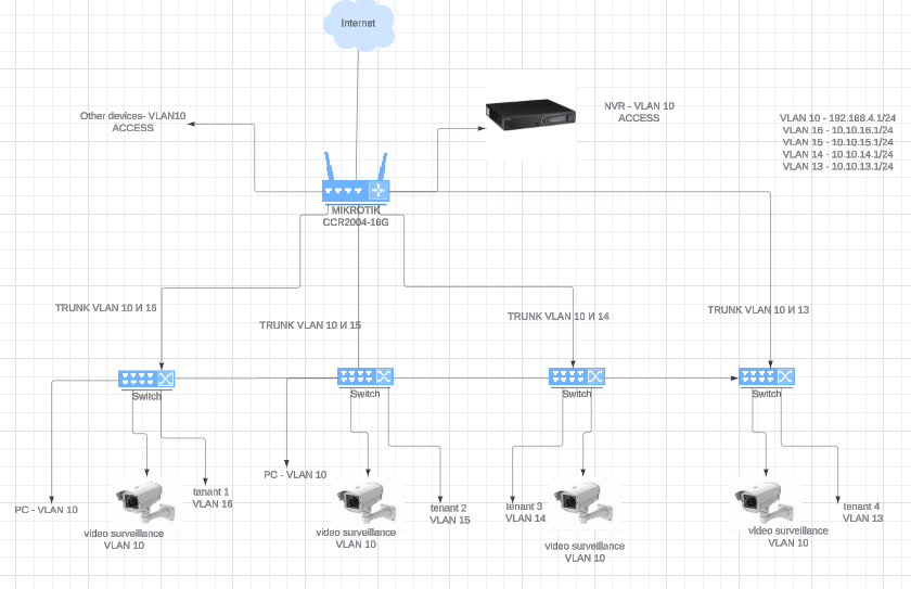

I have the following case:
I have a basic router Mikrotik CCR2004-16G-2S+ From several of the ports different VLANs go out with id:13, 14, 15, 16, etc. which are for tenants of the building and accordingly VLAN with id:10 which is for internal use and the cameras are attached to it. I add different networks to the different VLANs and DHCP to them accordingly. Accordingly, to each individual switch, I put in the trunk, for example, VLAN16 for the tenant and VLAN10 to monitor the cameras. The networks must not be visible to each other. My problem comes from not being able to run VLAN10 on more than one port. I must have VLAN 10 on the 13,14,15 and 16 VLAN in truck and i have VLAN 10 to another port on access.
I am attaching a schematic diagram.
Thanks in advance.

Well I would recommend a separate management Network.
All the switches would get an IP on the management network etc..
Without seeing your config hard to help further.
What type of switches are these ( assuming basic managed switches ).
/export file=anynameyouwish (minus router serial number, public wanip information, keys etc.)
