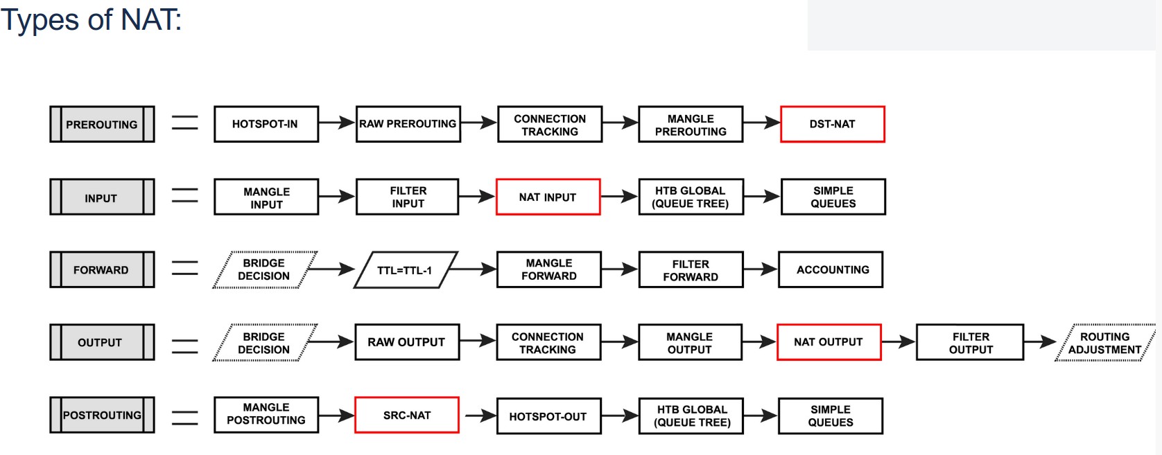

doesn’t seem to fit with this depiction of “chains” as NAT Types from rOS documentation;
Do the “filter” boxes represent the firewall chains, input/forward/output? Do the “mangle” boxes represent the “mangle chains”? In the Types Of NAT diagram can we think of the rows1- prerouting/3-forwarding/5-postrouting as the treatment of packets not going to or coming from the router itself? Do rows 2-input/4-output apply, like firewall input and output chains, only to packets that go to/from the router itself?
I would like to be able to construct a (large) PP slide that shows all packet paths, but I don’t yet understand enough.
