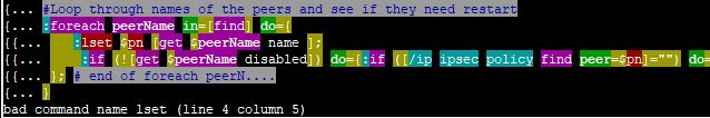

Second option:
You can also use
/system script edit number=xx source
for scripts and for schedulers it is:
/system scheduler edit number=xx on-event
In that you can do more but it looks just horrible because of the blank on blank and more blank lines.
It is displayed if you use { and } to contain the bit of code:
#Loop through names of the peers and see if they need restart
:foreach peerName in=[find] do={
   :lset $pn [get $peerName name ];
    :if (![get $peerName disabled]) do={:if ([/ip ipsec policy find peer=$pn]="") do= {:log error "$pn not active, restarting.."; disable $pn; :delay 1500ms; enable $pn}};
}; # end of foreach peerN....
