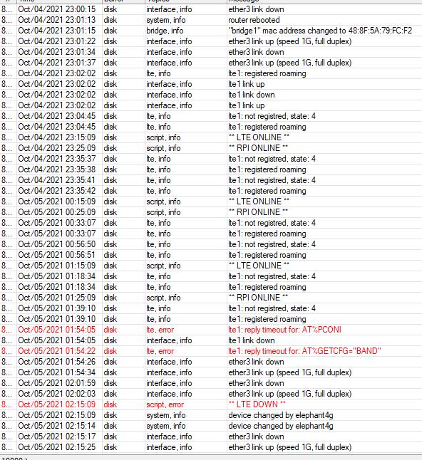

Sorry to resurrect this thread, i wanted to ask a question if i may.
Is there a way to alter this script so if the ping response fails three times it will reboot the router rather than disable / enable the LTE interface.
I have seen the below issue a couple of times and i believe the LTE interface is crashing due to a number of “not registered” errors but i am not sure if that means the LTE interface doesn’t exist which the script does check for. The above example happened following an automated router reboot which happens everyday at 23:00
