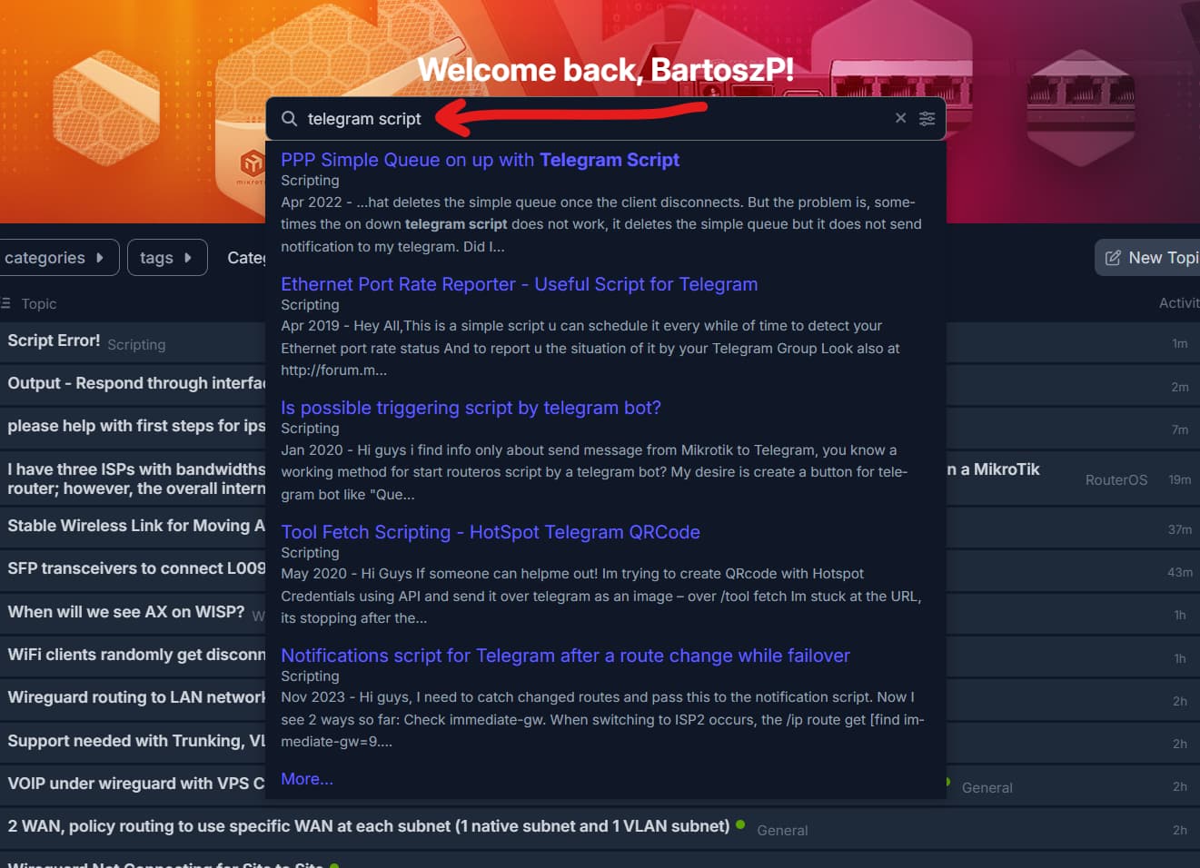

ChatGPT & Gemini… both!
So ask them for help.
I created the script via Wiki, then Gemini said it was wrong and corrected it! I saw how much it was corrected!
Do not believe LLM. It ouputs just an aproximation of the expected result.
Where do you think I went wrong?
Do you have a solution?
The problem is assuming that AI is a solution.
The solution is to write the script yourself or copy/adapt working one. Try to search the forum for countless topics on Telegram.
There is a whole video on sending notifications using Telegram on MikroTik’s YouTube. And if you search on forum, I suspect you’ll find something closer.
But first it was making up “continue”, “else-if”, “has”, now it’s using “:remove” and making up attributes. You can try using /system/script/edit from CLI which will show errors like print. But it’s not just syntax error that are the problems here (what’s attributes it’s reading, and looks like other logic errors).

I haven’t seen the script I want anywhere. I have a lot of different routes that are checked via ping. If a route is disabled, it will be transferred to another route.
Now I want a script that will send me a message on Telegram if there is a change in the routing.
