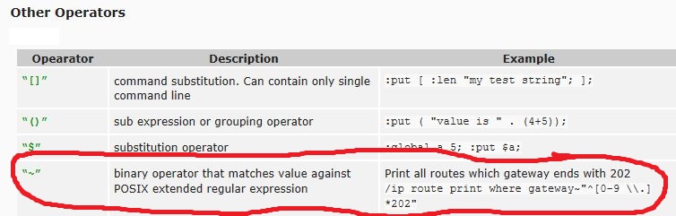

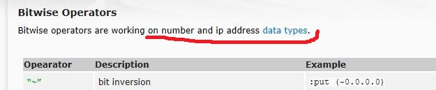

~ are for bit inversion :frowning:
use my example, or in short if you want the solution without thinking :sunglasses: :
:put [/ip route find dst-address=0.0.0.0/0 (routing-mark)."" = ""]
:laughing:
Only when used with numbers! :
But if you use it with strings it works different:
Source: http://wiki.mikrotik.com/wiki/Manual:Scripting#Operators
