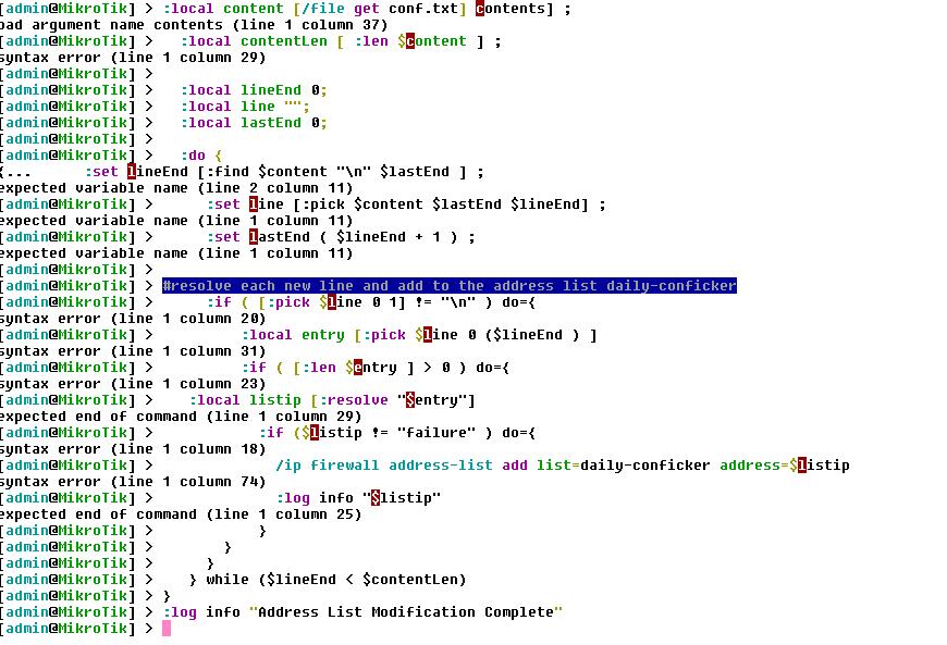

Hi there
i use this script in x3.17 its not working for me i just modified the script to check they resolve the ips . i created the file name conf.txt and put the all domain which listed on site. i used opendns for nameserver
:local content [/file get [/file find name=“conf.txt”] contents] ;
:local contentLen [ :len $content ] ;
:local lineEnd 0;
:local line “”;
:local lastEnd 0;
:do {
:set lineEnd [:find $content “\n” $lastEnd ] ;
:set line [:pick $content $lastEnd $lineEnd] ;
:set lastEnd ( $lineEnd + 1 ) ;
#resolve each new line and add to the address list daily-conficker
:if ( [:pick $line 0 1] != “\n” ) do={
:local entry [:pick $line 0 ($lineEnd ) ]
:if ( [:len $entry ] > 0 ) do={
:local listip [:resolve “$entry”]
:if ($listip != “failure” ) do={
/ip firewall address-list add list=daily-conficker address=$listip
:log info “$listip”
} while ($lineEnd < $contentLen)
:log info “Address List Modification Complete”
Yes, as noted in my post above, I only found out after finishing the scrip that the mikrotik :resolve command is currently broken, any failed resolution simple forces the script to quit, hence using opendns is the only way I see to get it to complete at this time.. too bad we’ve got no other solution for the 1st April :frowning:
However, if you’re still getting an error in the script even thou all addresses are resolving, run it from terminal instead and let me know what line it errors on and I’ll have a look.

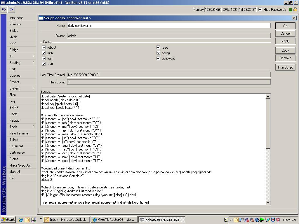

The Script was stuck-up how to debug ? currently using opendns nameserver terminal output
[admin@MikroTik] > /system script run daily-conficker-list
status: connecting
– [Q quit|D dump|C-z pause]
failure: connection failed
Hmm it would seem that your mikrotik is unable to download the files from my webserver.
Does the box you’re using have a default route (0.0.0.0/0) out to the internet?
The script as noted above does work fine on 3.17 which means there is an issue with your mikrotik being able to connect to my server somehow.
mm strange ! anyway i just tweak with this script with my linux box downloaded files on linux box then retrive to local machine. files are http://192.168.0.1/conficker/www.epicwinrar.com/conficker/
after this get sucess but 20% the script now given this error
status: connecting
status: finished
failure
i checked in files the only 1 file download 03-30-2009.txt
i changed in script marked

If it gets the failure message it means the :resolve has failed and stops the script from continuing (the bug mentioned in my second post)
If you’re using opendns servers (208.67.222.222 208.67.220.220) as your dns servers this should not happen as any invalid requests will instead be returned an opendns address (normally in the 208.67.X.X range)
#cleaning up
/file remove conf.txt
This works fine on 3.19 as long as the dns servers are set to opendns as stated above.
Is there any way to prevent duplicate ip addresses from being added to the address list since many of the ips are the same.
